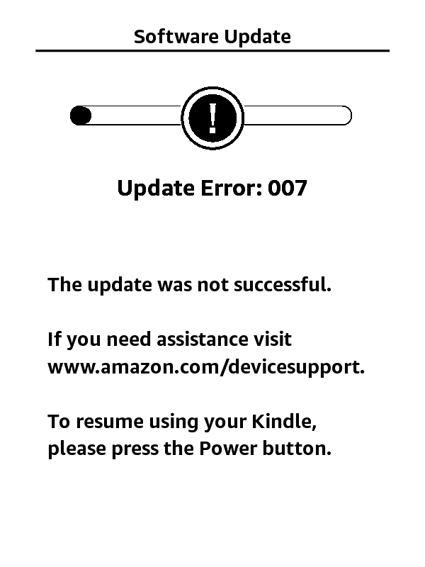

This is what I get when I try to install the 1.16 Hotfix:

Old 02-10-2020, 01:46 PM   #8
NiLuJe
BLAM!
NiLuJe's Avatar
Posts: 13,506
Karma: 26047202
Location: Paris, France
Means the JB is kaput.
