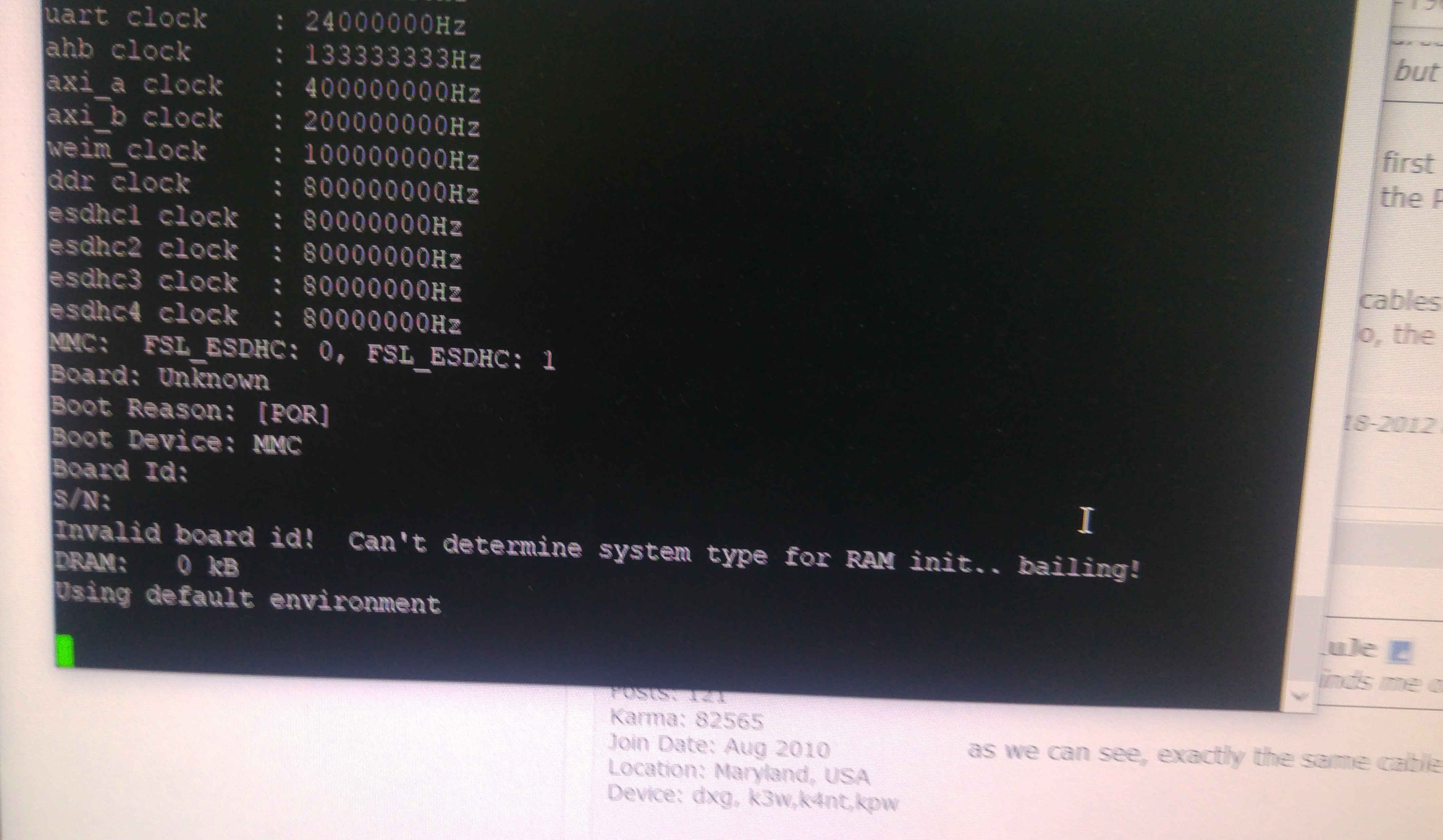

My Kindle PW1 stop working. So I used Putty through ttl to start it.
It shows the Id/SN are missing. It can't detect the board.
So it struck at using default environment. And it drains battery very quickly.
What should I do now? Try to access fast boot or overwrite firmware?

The screen is here.

U-Boot 2009.09-1ab126( Nov 29 2012-23:18:55)
CPU: Freescale i.MX50 family 1.1V at 800 MHz
mx50 pll1: 800MHz
mx50 pll2: 400MHz
mx50 pll3: 216MHz
ipg clock : 66666666Hz
ipg per clock : 66666666Hz
uart clock : 24000000Hz
ahb clock : 133333333Hz
axi_a clock : 400000000Hz
axi_b clock : 200000000Hz
weim_clock : 100000000Hz
ddr clock : 800000000Hz
esdhc1 clock : 80000000Hz
esdhc2 clock : 80000000Hz
esdhc3 clock : 80000000Hz
esdhc4 clock : 80000000Hz
MMC: FSL_ESDHC: 0, FSL_ESDHC: 1
Board: Unknown
Boot Reason: [POR]
Boot Device: MMC
Board Id:
S/N:
Invalid board id! Can't determine system type for RAM init.. bailing!
DRAM: 0 kB
Using default environment
Since Previous posts never solved. any one can tell me where to find working
Fast boot img?
Thanks,

No reply to your posts in two hours?
Maybe you forgot to pay your support contract here.
The eMMC has died on the board.
There are at least two threads here on the details of how to replace it.
Although, unless you have copied down those private, outside of the filesystem, values; you will still be S.O.L.
Sell as a used, working, replacement screen and junk the rest.

Four pieces of information:
- Serial number (you have that)
- Wi-Fi MAC address
- Board ID (referred to as 'mfg')
- PCB serial number ('pcbsn')
Your options are:
- Get these from a working unit.
- Hack up U-Boot to make it capable of initializing the board's DRAM without knowing what Kindle model this is (you have to read, modify, and compile the Lab126 U-Boot source code for this to happen). It's theoretically a check that you have to replace with a hardcoded value.
- Try random values (especially for Board ID) until something works.
- Try a sector-by-sector recovery of the internal eMMC to see if you can recover your board IDs. This data is on a user-inaccessible part of the eMMC.
This thread is a good starting point:
https://www.mobileread.com/forums/sh...d.php?t=271750

That depends on whether the current eMMC is damaged or just "forgot" the data.

No way to make one. You have to either use random numbers and pray you get lucky, or find a toast Kindle. I'd recommend you do the latter. They are as cheap as dirt on eBay.
- PCB serial number ('pcbsn') (The Sticker on the board?)
[/quote]
If the sticker on the board follows this template:
#XX#X#XX#XX##XXXX###
where # stands for a number and X stands for a letter, then this is a Board ID (mfg).
And if it follows this template:
###############X
then it's a PCB serial number (pcbsn).
But one question: why don't you patch U-Boot to ignore the serial number check and initialize DRAM as if it was a Paperwhite?
As a start, check the file board/imx50_yoshi/imx50_yoshi.c. It's a good start, and from a casual reading of the code, I can see code sections that are very relevant to the issue you're facing.
