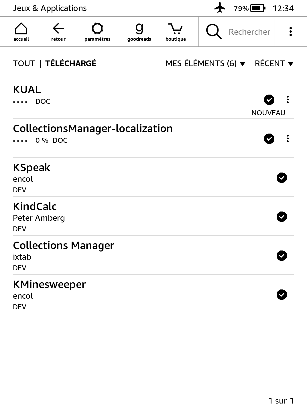

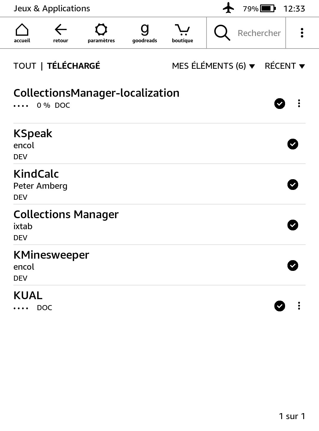

Also works fine on PW3 5.10.2
Before: Click image for larger version
ID:	169325 After: Click image for larger version
