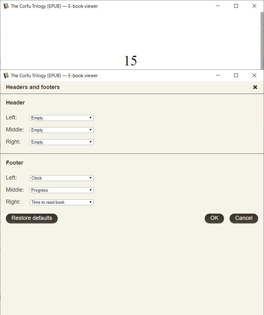

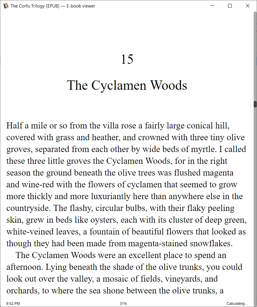

After installing Calibre 4.1, the ebook viewer still shows calculating for the time to read book/chapter/chapter&book items. I am assuming that by the time I have read 30+% of the book, somewhat logical numbers should be displayed.

Hmm could be I broke it while adding support for book position, I will take a look at it when I have a moment.
Old 10-08-2019, 02:10 AM   #5
Posts: 45,655
Karma: 28549046
Works for me. Note that it will ignore scrolls that happen in under 2 seconds, so it really only works well if you turn page by page and take at least 2 seconds to read a page.
Old 10-08-2019, 02:21 AM   #6
Posts: 48,641
Karma: 174510110
That would be the issue then. I just opened another book and waited around 4 seconds between page turns. Somewhere around the 6% mark, the time to read the book kicked in. The first books I was looking at were recipe books so I was skipping around quite rapidly.
