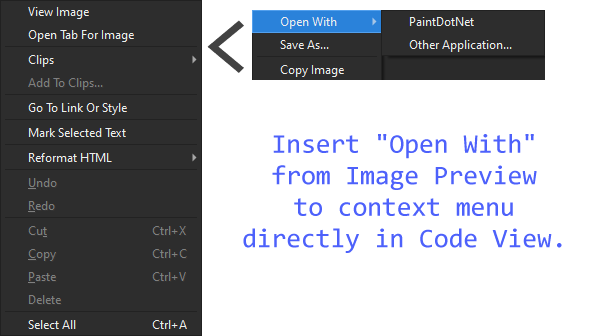

When in CodeView I do right click on an <img> tag, the contextual menu allows me to open the image in a tab. Would it be possible to add the "Open with..." command to that contextual menu (right click on an image tag), so instead of opening the image in a tab and from there, to open it in an editor program, I can do all in only one step?

Old 02-14-2020, 12:41 PM   #3
BeckyEbook
BeckyEbook's Avatar
Posts: 900
Karma: 3501166
Join Date: Jan 2017
Location: Poland
If I understood correctly, then ...
BeckyEbook is offline   Reply With Quote
Old 02-14-2020, 12:55 PM   #4
DiapDealer
DiapDealer's Avatar
Posts: 28,915
Karma: 207182180
That would make sense, I guess. But I admit I'm still quite confused about the "All in one step" comment.
It all would depend on how modular the "Open With" code is, and whether or not the Code View widget would be able to supply the same information that Book View's TreeWidget/Model does to create the context menu item.
Old 02-14-2020, 01:06 PM   #5
RbnJrg
Posts: 1,881
Karma: 8821117
Join Date: Mar 2013
Device: Kindle 4 NT
That's right! That is what I wanted to say.
