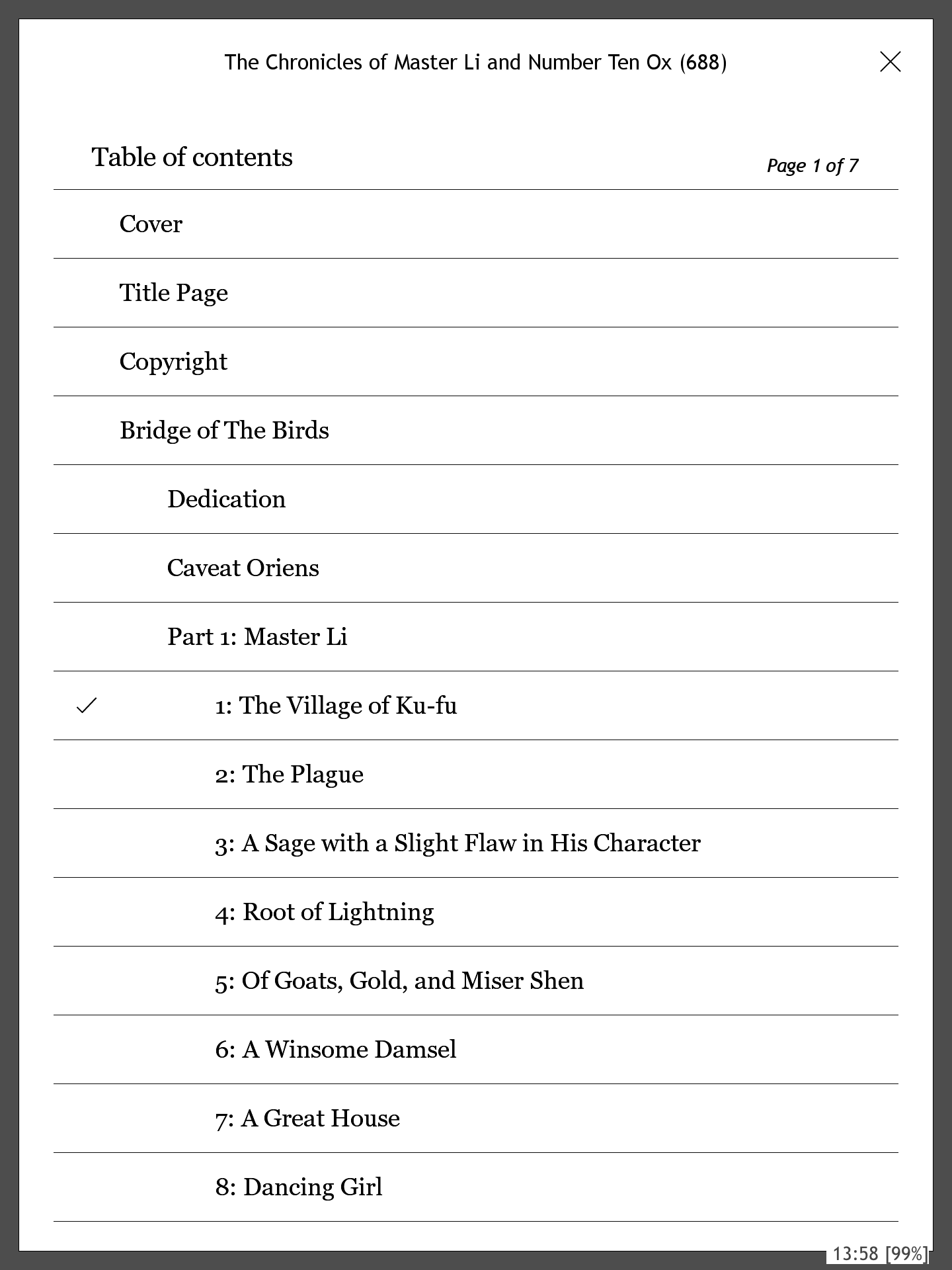

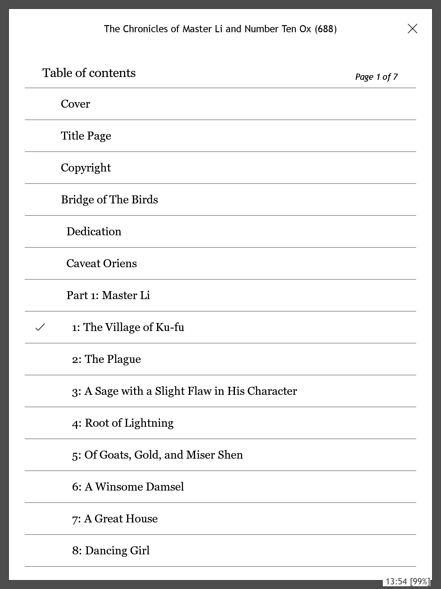

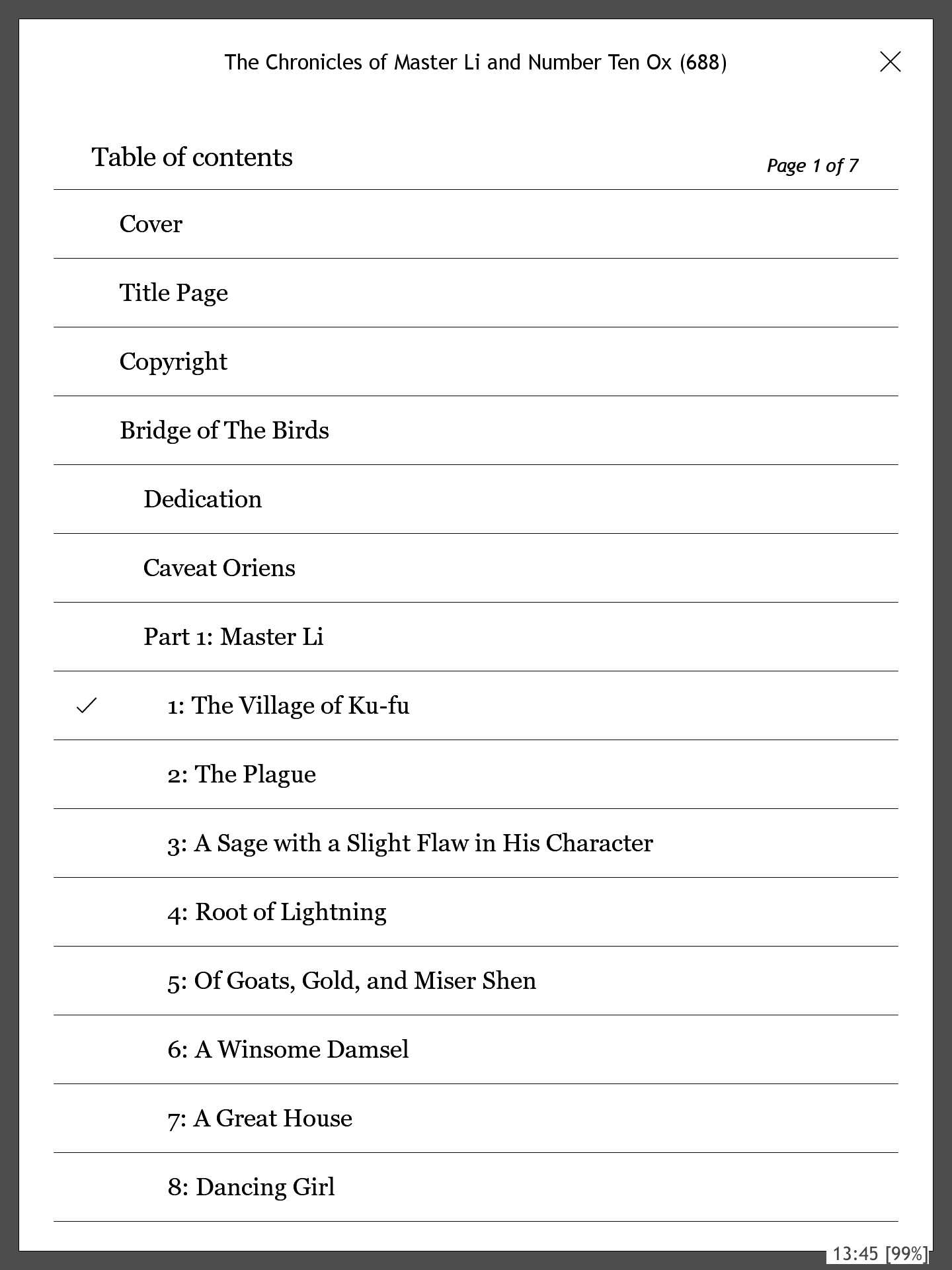

For anyone trying to decide whether to enable the new TOC patch 'Increase TOC level indentation and fix extra indentation bug'. Here are some screencaps for comparison purposes.
  • left: patch disabled (indent = 2, top level indented)
  • middle: patch enabled (indent = 2-squared, top level not indented)
  • right: customised patch enabled (indent = 2-cubed, top level not indented)
ETA: I should have mentioned that these screencaps are from a Forma. Bigger indents on a 6" screen might not be ideal.
ID:	171698   Click image for larger version
ID:	171699   Click image for larger version
