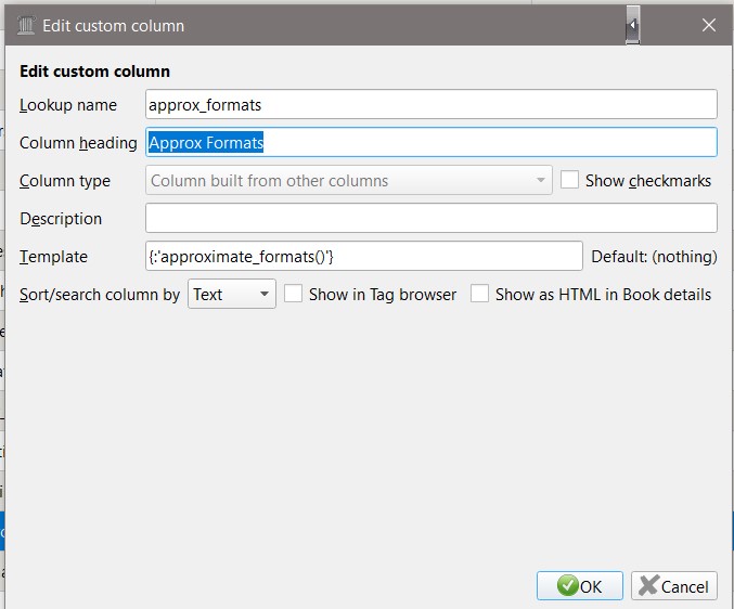

If the template in the 'phantom "Formats"' column is {:'approximate_formats()'}, there is no bug. See ==>> approximate_formats()
returns a comma-separated list of formats that at one point were associated with the book. There is no guarantee that this list is correct, although it probably is.
In my Test library I have a column called #approx_formats/Approx Formats, which uses that template. It shows a single string e.g. "DOCX,EPUB,AZW3" in the book details panel, if I click on it calibre does a search e.g #formats:"=DOCX,EPUB,AZW3" and shows me all the books that have that string in #approx_formats.
Maybe your crash is due to the fact that you have two columns with similar names, the built column formats/Formats and the user defined custom column #formats/Formats. I used a different name for my custom column because having them the same would have confused me .
You might want have a look at the formats_paths() function. However, I am pretty sure this interrogates the file system, which will have a negative impact on performance -- hence the provision of the approximate_formats function.

I just added a new custom column by clicking 'Formats' in top line, that created a column with #formats/Formats lookup and column names - it also used a different template to my years old #approx_formats/Approx Formats, viz:
Name:	New Formats.jpg
ID:	173259 Click image for larger version
Name:	Old Approx Formats.jpg
But it works just like my old one when I click on it on Book Details
I wonder what the OP has in the Sort/search column by, Show in Tag browser, and Show as HTML in Book details attributes. I suggest he/she tries setting them to Text, unchecked, unchecked.
