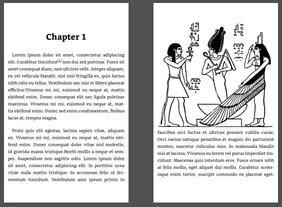

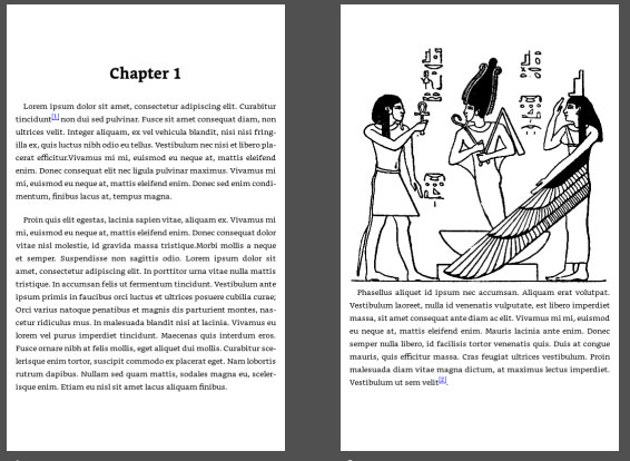

Amazon has been working of as solution for this problem. The latest version of the Kindle Previewer supports the CSS property "float: snap-block". This allows text to be repositioned around an image in a way that avoids extra blank space in most cases. It only works for Enhanced Typesetting (KFX format).
I haven't worked out all of the rules for using it and there is no actual documentation from Amazon. You can read a bit more in this thread: Kindle Previewer 3.40 - 64bit, SVG text, snap-block.
As a test I modified your sample book to add snap-block to the first image. After some trial and error I was able to get it to work. The attached images show how the Kindle Previewer renders it at two different font sizes.

@jhowell proposal to use .kfx and "float: snap-block" works, I was able to recreate your result(it works perfect with different font size):
BUT "float: snap-block" seems works only on <img> with <p> around it. As soon as you replace raw <img> with sth more complicated like <figure> or <svg>, everything backs to normal (ugly empty space). And problem with captions arise.
I try hack it by using <p> as replacement for <figcaption> but result disappoint me:
I try draw text/caption in <svg> but as I mentioned above "float: span-block" doesn't work with anything beside <img>.
