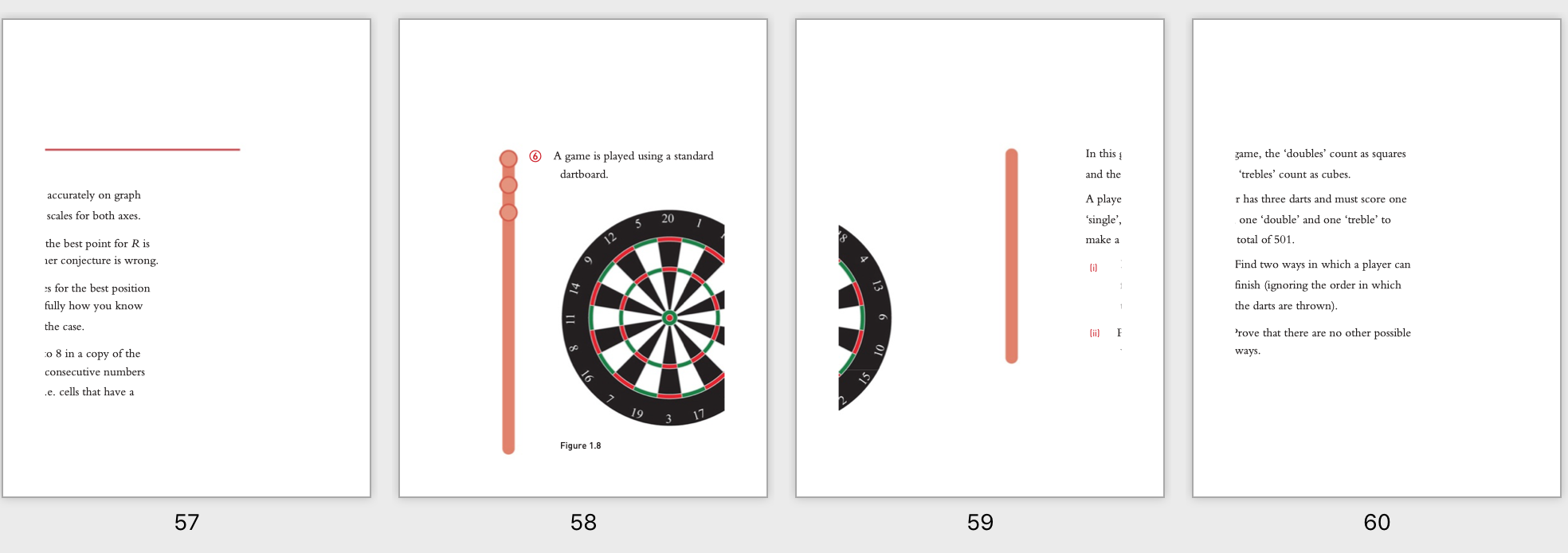

I’m trying to convert a AZW3 file to pdf but when I do the pages split up like the photo below. How can I change the settings so 1 page from the AZW3 is 1 page in the pdf?
It takes 10 hours each time and the settings I tinker with don’t correct it!

That looks like a fixed layout ebook. These are not really supported by calibre, so you are not going to get good results, regardless of settings.
Old 06-30-2019, 04:54 AM   #3
Posts: 45,609
Karma: 28549044
You can check by opening it in the viewer and seeing how it looks there. PDF conversion basically uses the viewer internally.
