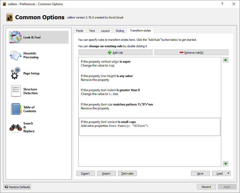

Allow me to introduce to you the wonderful feature that Kovid introduced a few months ago, in response to a feature request I made:
Introducing Transform Styles...
This feature, found in the common options for conversion options has a tab called Transform Styles.
At the end (I think?) of the conversion, calibre will apply any rules set here to alter the CSS in the converted ebook.
See the attached screenshot for some examples of things you can do with this option.
Note, if you save a set of rules, you can also use them in the ebook editor for ebooks already in the desired format (epub or azw3

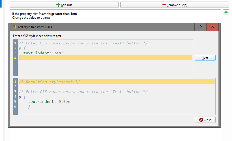

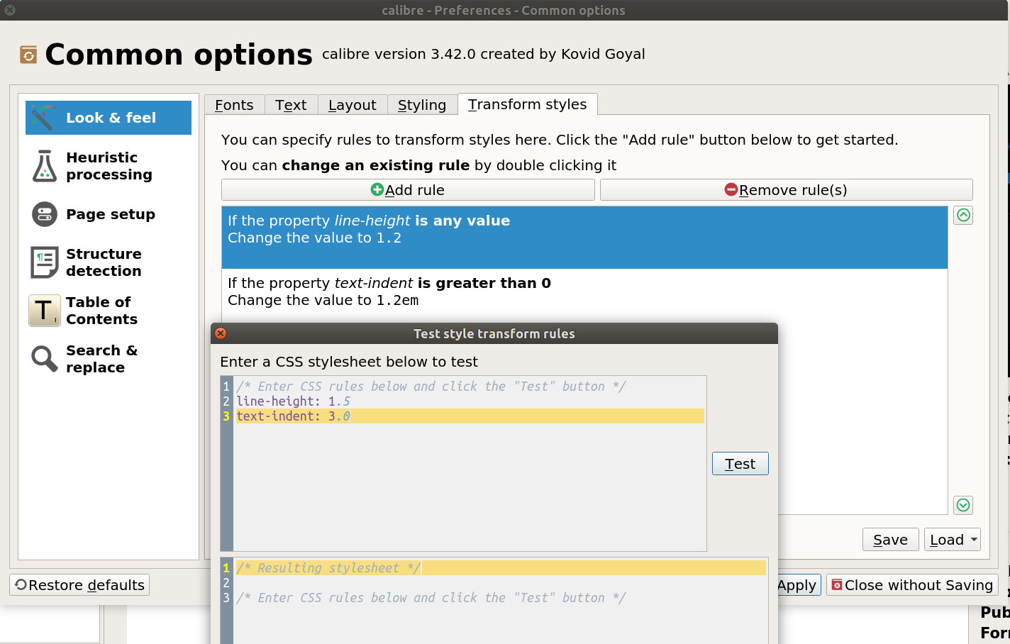

Excellent tool, I had not noticed it before. But I can't seem to get it to work
When I try the test, I get nothing, and the values I type in like 1.5, have the 1 in red and the .5 in green, which looks fishy. Can someone give me a pointer?
Thanks!

Well, I can't get the test to work no matter what I put in, but the tool actually does the job, at least in the editor. But I've got about 100 saved searches that are very specifically tuned to my work. I'll play with this...maybe find something that could cut down on the number of searches I run.
