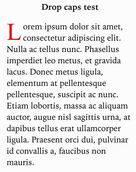

In my humble opinion, Doits, it's not possible. I wish to hell it were. We've done I-don't-know-how-many books with dropcaps, both print and eBook, and there's simply not one-size-fits all.
There's a new initial-letter CSS rule that'll make creating drop caps much easier.
For example:
h1 + p::first-letter {
  -webkit-initial-letter: 2;
  initial-letter: 2;
  margin-right: 0.2em;
  color: red;
However, I've found only one app that actually supports this new rule: iBooks.
EDIT: Gitden Reader also supports initial-letter, but not ADEPT DRM.

Can you show me a different letter that isn't boxed?
I haven't got the faintest idea how to do this, I merely adapted the website code for epub3 books. (I won't use drop caps CSS, until initial-letter becomes widely adopted.)
One minor nit is that if you have any text between the h1 header and the paragraph where you want the drop cap, it will receive the drop cap instead.
I didn't mention this issue, because I assumed that it'd be obvious to ebook designers familiar with pseudo selectors.
