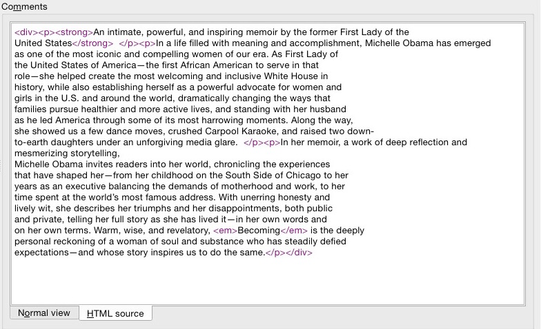

Hey guys,
Joined the forum because I have a very specific question I cannot find the answer to: some of the summaries on my Kobo Aura show line breaks and others look perfectly fine. Sometimes there's also an abrupt font change.
I use the Calibre 'Comments' field to add the summaries. In Calibre everything looks fine. When I check the metadata html, the summary is coded in seperate lines, rather than one line, which is what's causing the linebreaks:
When there's a font change, it's also reflected in the html.
I've had this happen with summaries I got via 'download metadata', that I c&p into the box or that were already embedded in the file. The only thing that fixes it is editing the html or manually replacing the space where the line break is in the 'Comments' field.
My question is, does anybody have any idea why this happens and how I can fix it in bulk or prevent it from happening in the future? I have 2000+ books in my library, checking and manually changing all of them would be a huge effort.
Thanks!

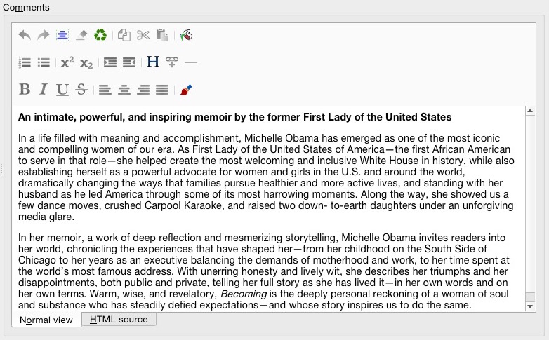

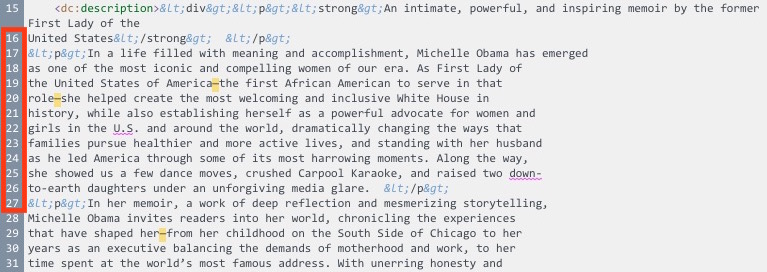

Thanks for the suggestions! Here's what I tried.
Originally Posted by thiago.eec View Post
@agirlnamedfia Have you tried using Edit metadata in bulk > Search and replace?
The <p> one won't be useful because there aren't any <p> tags where the line breaks occur. I'll try the style tag search for fonts/font sizes, though, thanks for that!
Originally Posted by ilovejedd View Post
Iirc, there's a Calibre plugin available to strip all formatting from comments. I think it was called Clean Comments or something?
The only thing it did was change the line breaks to <br/> and thus making them visible in the "Edit metadata" window, unfortunately.
I believe this is an issue with the latest Kobo firmware version, version 4.14.12777. It seems to be rendering any line breaks in the comments. Before, they were either ignored or rendered as a space. I hadn't notice it until someone else reported it. I tend to clean the comments of line breaks, so I don't usually see this. And I haven't done enough testing to be completely sure of what is happening.
I haven't seen any issues with fonts changes. Any strangeness there on the device, I can see in calibre and fix there before resending the books.
Also, your image isn't showing. You could post the code within code-tags so that we can see what you have. That might help to prove what the issue is if I am wrong.
If that's the case (which it might be), wouldn't it be a problem for every book, though? So far, for the 700 or so that I've checked, only about 1/4 had the issue.
Anyway, apologies for the image not showing. Should be fixed now? I can't show you the code in tags because it won't show what the problem is, but I took some more screenshots...
This is what the code in "Edit Book" looks like. As marked, the line breaks happen when every line gets a new line number, for lack of a better explanation:
This is what the "Edit Metadata" comments section looks like in normal view, where no line breaks are visible:
This is what the "Edit Metadata" comments section looks like in HTML view, where you can see the line breaks:
If I remove the line breaks in the HTML view, then the problem is solved, but like I said before, I'd rather not have to check all the books and manually change them if I can at all help it...

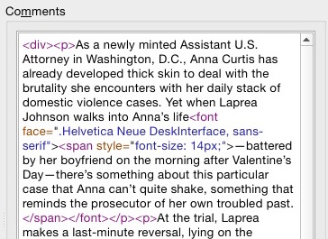

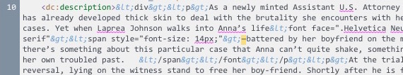

UPDATE: I came across another book where the font spontaneously changes mid-summary. I tried
  • Comment Cleaning
  • search and replace
  • Erase all formatting
None of these got rid of the font code.
Here's what it looks like in the HTML view of "Edit Metadata":
And here is what the code looks like in "Edit Book":
Also I haven't a clue what's up with the image hosting (I uploaded them to a public MobileRead album and copied the BBCode, I feel like that should work?) but I hosted these externally so HOPEFULLY you'll be able to see them. If not, see attachments.

Another thing you can try installing is the Job Spy plugin. It has an option to convert comments into plain text.
P.S. Please note you'll need to run Polish books, Embed metadata, Convert or use the Send to device function to actually update the embedded comments metadata in the ePub file sent to the Kobo.
P.P.S. I think the latest version of Calibre gets rid of the line breaks when downloading comments metadata. For existing comments though, you could do a search and replace to convert them to space.
Search field: comments
Search for: \n
Replace with:  (space)
P.P.P.S. And for removing <font> tags.
Search for: <font[^>]*>(.*)</font>
Replace with: \1

Old 05-10-2019, 04:36 PM   #9
thiago.eec
Posts: 1,295
Karma: 1436993
Join Date: Dec 2016
Location: Goiânia - Brazil
The problem is that your comments have line breaks inserted with the ENTER key. This creates a non-visual mark (LF) on the end of each of those points. You can also use regex to get rid of then:
Search for: "([^>])\n"
Replace with: "\1 "
*remove the quotation marks and make sure you put the space after the "1"
Well, regex gain:
Search for: <font(.*?)>(.*?)</font>
Replace with: \2
Last edited by thiago.eec; 05-10-2019 at 05:15 PM. Reason: correction for the font code

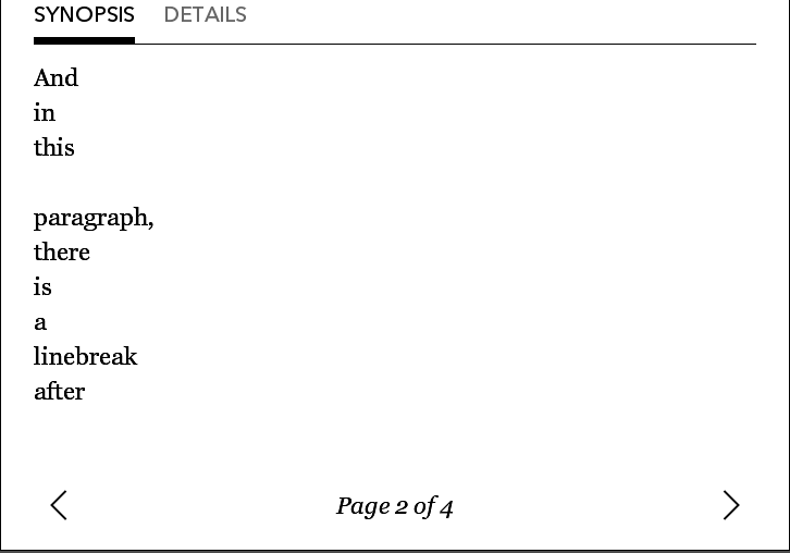

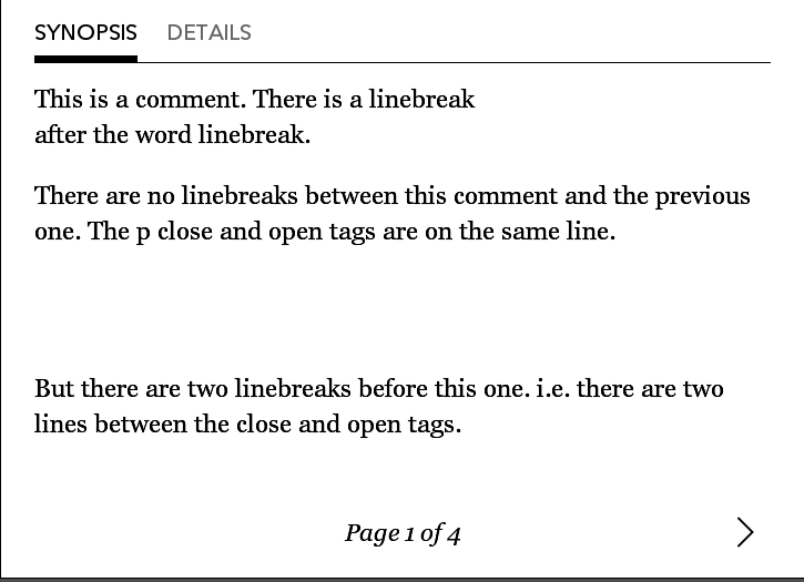

And that is exactly what I was expecting. I expect there to be linebreaks after "First Lady of", "has emerged" and so on. And a double space between "United States" and "In a life of". In previous Kobo firmware versions, the first example would be on a single line (unless they wrapped there) and there would be a single line between the paragraphs.
To demonstrate this, the attached book has the following in the comments in calibre:
<div><p>This is a comment. There is a linebreak
after the word linebreak.</p><p>There are no linebreaks between this comment and the previous one. The p close and open tags are on the same line.</p>
<p>But there are two linebreaks before this one. i.e. there are two lines between the close and open tags.</p><p>And
in
this
paragraph,
there
is
a
linebreak
after
each
word
. With
two
linebreaks
after
the
four-letter
words.</p></div>
The screenshots are from device. They show the first two pages of the synopsis for this book when I sideloaded it. The screenshots show the linebreaks and multiple empty lines where here linebreaks are in the comments.
If this isn't what you are seeing on the device, we need to see screenshots or photos to show what you are seeing.
A quick fix for this seems to be using a metadata plugboard for the comments. Apparently the template "{comments}" will remove the linebreaks.
