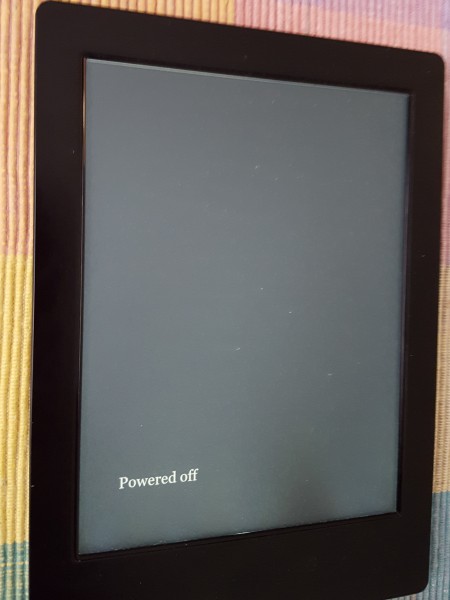

How to figure out if my screen is dead?
Kobo Aura H2O 1st edition: How to figure out if my screen is dead?
I think the screen on it is dead. The backlight still works. Little white lights on the power button still flash when it seems to be turning on or off. In lower left quadrant, the works "Powered Off" _never_ disappear. Otherwise, the screen is blank.
Can anyone suggest tests I can do to validate my hypothesis that my reader is working but the screen simply will not cooperate?
Not looking for 100% confirmation, but 98% would be nice. I need to know if to replace or if there's hope to resurrect this screen/device.
("Extra credit" for methods that do not involve complicated interfacing with a PC. Simple interfacing okay.)

Post a picture or do a search of the forums for broken substrate and look at the pictures of that and you'll likely have your answer very quickly. My guess would be broken substrate and it's dead.

I tried connecting to Windows 10 machine. No go. Possible I did not manage to hit the Connect button, since I don't know where it is.
Connected USB cable, Kobo "on". Tried to find Connect button. Turned Kobo off and back on (to extent those flashing lights mean anything!). Disconnected then reconnected USB cable. Tried again--less carefully--to find Connect button.
A couple more details I forgot to add in the original post:
- Resetting the device (paperclip in the pinhole) also causes the power button light to flash, but the screen still does not change
Created a photo, should show here (first time adding image). Kobo "on" and backlight on. Photo angled as that was a quick way to avoid any shadowing on the screen caused by the camera and me.
Curious if anything new occurs to you. At this point it seems likely the device is a goner.

From what I can see, you haven't tried a manual factory reset. The pinhole reset doesn't do this. It just forces a power cycle. The factory reset instructions are in the Wiki. I don't think it will help, but, you should try it.
My guess is that the backplane is cracked. The blank power off screen is probably the worst one for showing that as it is a uniform black. If it was an image, you might see the problems. But, they can also be around the edge and not visible. If you open the device, and look at the back of the screen, it usually becomes obvious.
At this point, it might be worth opening and checking the screen and any connections. The light and screen are on different cables (in the devices I have opened at least), so the screen could have come lose. And you could try to reimage the internal SD card if there is nothing obviously wrong with the screen.

Thanks for the wiki link. I had not tried the no-dancing-squares reset. Just tried it, although given it's my first try at doing this, I might not have performed the tapping correctly. Anyway, tried my best, and nothing new happens.
The only effect had by any troubleshooting is to cause power button lights to blink or glow briefly, and to turn backlight off and on.
I'm going to give up on it and plan to get a new ereader. Don't have time to dissect it or even try to sell it as-is or give away, so just putting it on the shelf for now. Will be searching to see if any of low-moderate price are reputed to be more durable than the likes of Kobo Aura H2O 1st edition.
