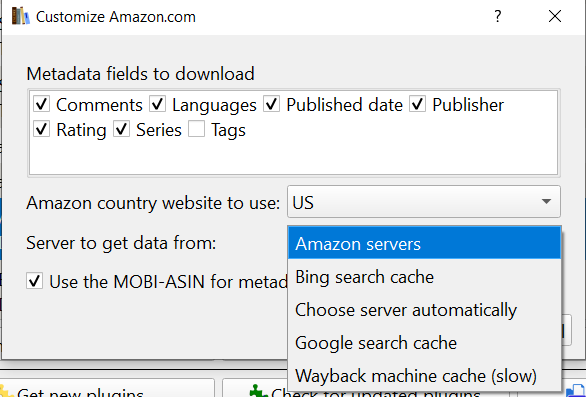

Have you taken a look at your plugin configuration? See the attached image. I've found that using Amazon servers seems to work best for me though I do toggle the country between Canada and US. If you do a large number of metadata updates rapidly, I've found that Amazon will throttle your connection causing timeouts before getting usable metadata.
Calibre 5.11 has v1.2.15 for the Amazon metadata download plugin but that plugin ships with calibre, it is not a third party plugin.

If I remember correctly, the built-in metadata source plugins are downloaded automatically when they are updated. You should have it.
What error are you actually getting? Post the contents of the log after a search so we can see what is happening. Or, as @DNSB suggested try different servers and see if that gives better results.
