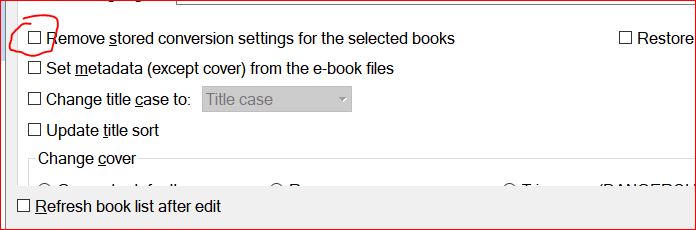

Thanks. Unfortunately, it does not remember what I enter. I have to put it in every time?
I guess it's still quicker than editing the book
Maybe the user doesn't want to do this with every book, so a check box to "always use these options" would be very welcomed. Makes it possible to do batch conversion.
Calibre has Defaults (preferences: <conversion section> ) that are used (suggested) when you FIRST convert that title. After that, THAT title, remembers the setting used.
The Conversion Dialog gives you a chance to Override the default or saved choices
If you want this for All NEW book conversions:
Preferences: Common options: Look and feel
If you want to CLEAR all saved
Select books to do: Tap "E" (bulk mode MDE): tick the box shown
