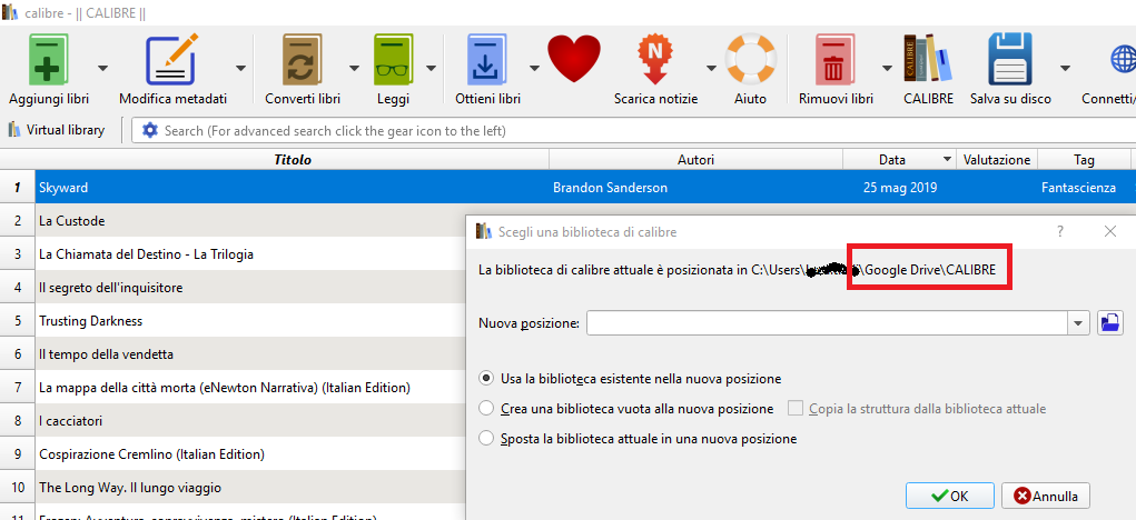

Hello, I recently changed my phone and my cloud service and now I'm unable to use CC because it does not recognize the right calibre folder in the cloud.
My data folder of calibre is ..\GoogleDrive\CALIBRE like you can see in the picture below. Calibre on PC works perfect.

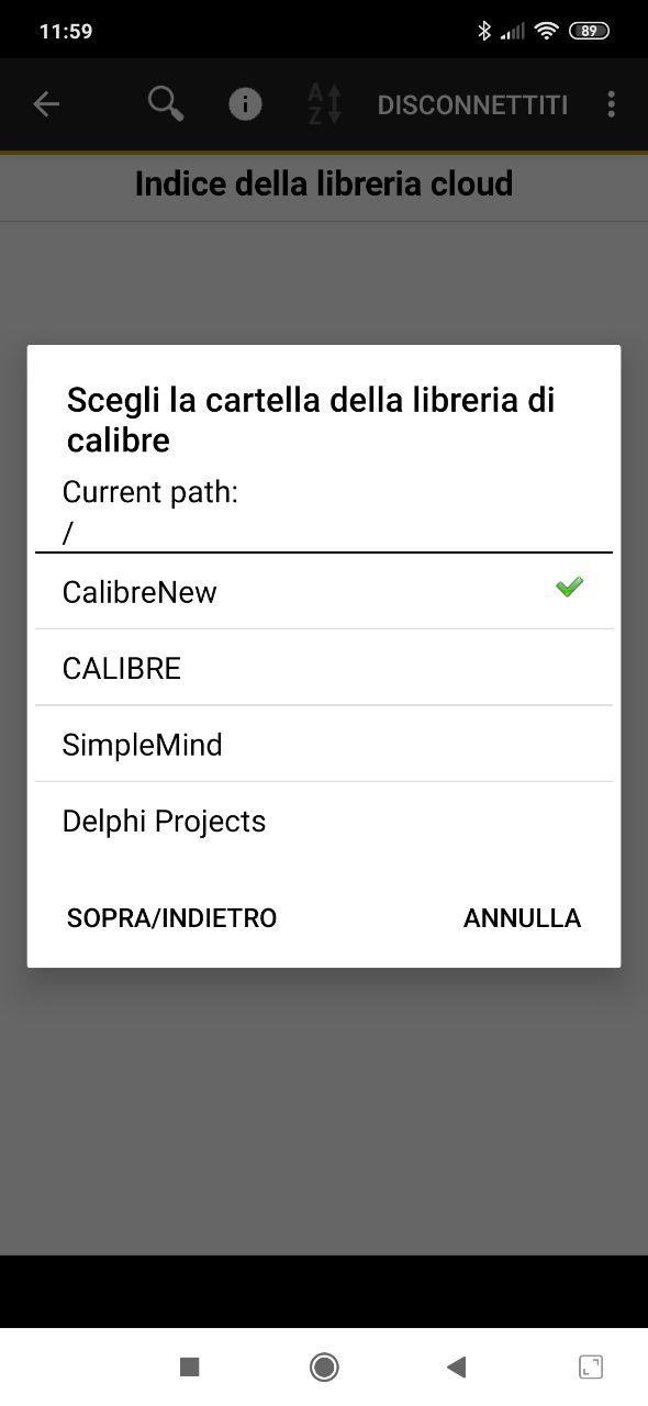

The problem like you can see in the following picture is that connecting with my phone I see the "CALIBRE" folder but it is not selectable:
I tried to create a new empty library with calibre and Curiously this one is recognized by CC???

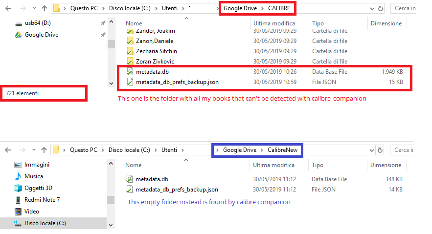

On my PC now I have the following situation and still unable to point to the right folder with CC
Any help will be really appreciated.

There is hardly anything really there in that Library. (330K seems to be an default-empty library, db)
If that was a functional Library FOLDER, in addition to those 2 files, you should also see Author folders
Old 06-03-2019, 03:06 PM   #7
