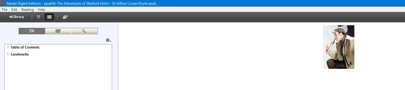

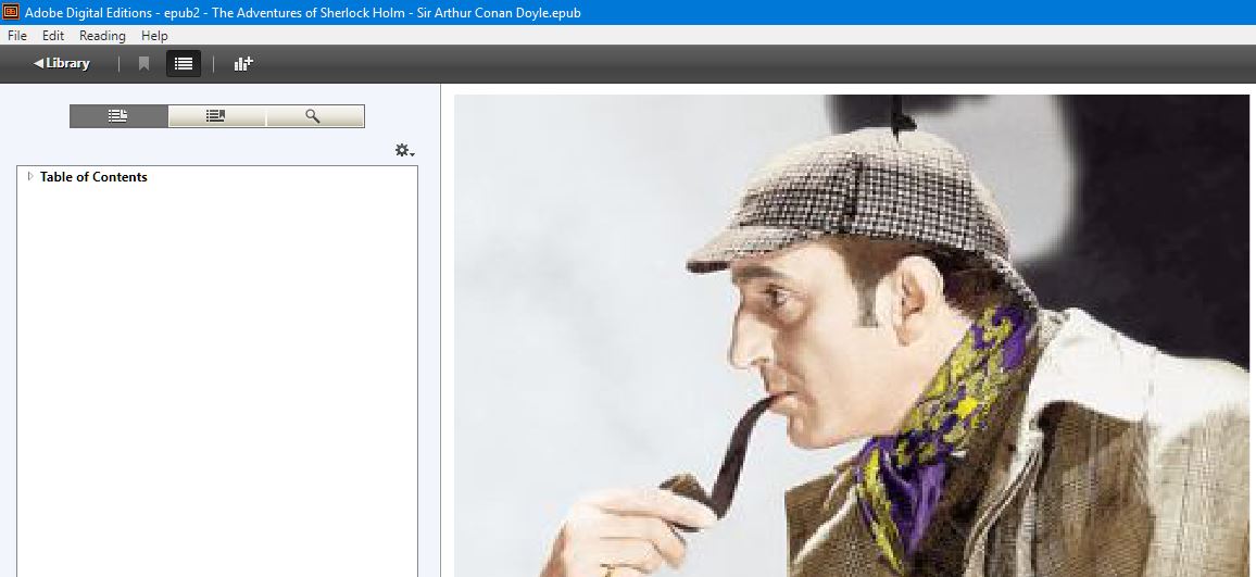

I upgraded an epub2 to epub3 to experiment/learn
Using ADE the epub3 cover image is greatly distorted
It 'seems' to be an ADE problem since the editor's File Preview is fine
Can anyone confirm it's an ADE issue?
ID:	163582   Click image for larger version

Is that the actual cover (i.e. the first page of the book) or just the cover image?
It's help if you posted a sample epub to re-create the issue. Although I dont think I even have ADE newer than 1.7.x installed at this point

They were screen shots of ADE v4.5.7 of the 'before' and 'after'
I loaded my epub2 version from a backup, upgraded it to epub3, and saved a copy
I did look at 'What's Changed' and saw a few references to Cover, but they all looked pretty harmless (to me at least, but then a lot of my changes do)

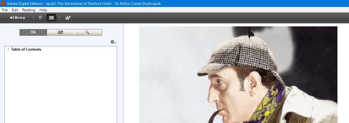

1. I went back to the epub2 file, deleted the cover html file, and added it with the [Add Cover] menu
So somehow I must have messed it up -- all I ever do intentionally is use the menu
epub2 --
<svg xmlns="http://www.w3.org/2000/svg" xmlns:xlink="http://www.w3.org/1999/xlink" version="1.1" width="100%" height="100%" viewBox="0 0 306 423" preserveAspectRatio="xMidYMid meet">
      <image width="306" height="423" xlink:href="../cover.jpg"/>
    </svg>
so at least the image is not distorted
2. The image size seems to have changed
After I deleted the cover html, re-added the cover, and upgraded to epub3 the image is much smaller
epub3b --
    </svg>
