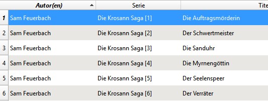

Hi David,
thanks for the quick answer.
But the concerning books do have a series index.
When transfering a single book without any series I get the following (same) error:
calibre, version 3.37.0
FEHLER: Fehler: Fehler beim Kommunizieren mit dem Gerät
float argument required, not NoneType
File "site-packages\calibre\gui2\device.py", line 87, in run
File "site-packages\calibre\gui2\device.py", line 540, in _sync_booklists
File "calibre_plugins.kobotouch_extended.device.driver" , line 476, in sync_booklists
File "site-packages\calibre\devices\kobo\driver.py", line 968, in sync_booklists
File "site-packages\calibre\devices\kobo\driver.py", line 2513, in update_device_database_collections
File "site-packages\calibre\devices\kobo\driver.py", line 3046, in set_core_metadata
TypeError: float argument required, not NoneType
Any Thoughts?
P.S. see screen copy attachment

Old 01-07-2019, 08:38 AM   #4
davidfor
Posts: 24,905
Karma: 47303824
Location: Sydney, Australia
Sorry, but, that is exactly the same error, and the answer is exactly the same. The only way that line can be giving that error is if the series index is somehow not set. I have no idea how that is possible.
I have put in a fix to handle this. This should be in the next release. If you cannot isolate the book that is causing the problem, you can turn of metadata updating in the driver configuration.
