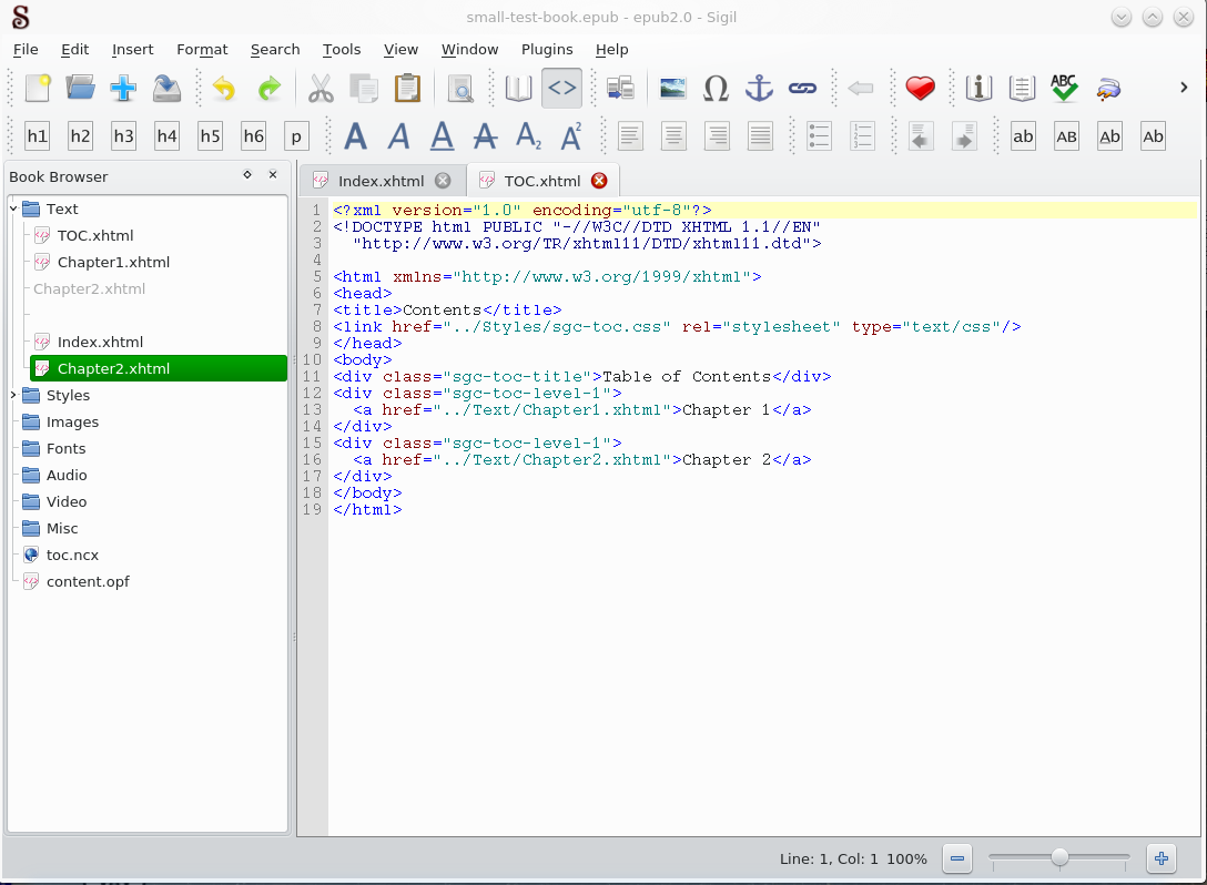

Sorry to wake up such an old thread, but I am seeing this on my Mageia 6 system. Let me know if this should be in a new thread.
The problem is that Sigil crashes when I attempt to reorder the chapter files. After moving the file, the tree in the Book Browser is weird. if I right click on the empty space, Sigil crashes.
I have attached screenshots of the GUI to show what the Book Browser looks like before I moved Chapter 2 up above the index and after I moved it. I have also attached a very small epub book that I use to cause the crash. I simply move Chapter 2 from below the Index to above it.
After attempting to move the Chapter 2 file, Sigil crashes when I right click on the blank space to open a context menu. This happens on the 0.9.8 version installed from the Mageia repos. It also happens on a 0.9.10 version that I built from source.

Interesting enough, this problem does not show up on my Mint system with Sigil version 0.9.5
System:    Host: LinuxMain Kernel: 4.4.0-137-generic x86_64 (64 bit) Desktop: KDE Plasma 5.8.9
Distro: Linux Mint 18.1 Serena
Qt 5.6.1
It could be a difference in Plasma 5, a difference in Qt, or a difference in Sigil version. I don't know.
Not being able to reorder the chapters is kind of a serious flaw. I can change the order by unzipping the epub file and editing the content.opf file, but that is a pain.

I've honestly about given up trying to account for all the tweaking, injecting, and general tomfoolery that Plasma/KDE does with their platform Qt5 (via themes and plugins and such). But some things to try might be:
1) From your screenshots, I see the icons are disappearing in the Book Browser Treeview after dragging files. We've very, very, very recently pushed a fix related to disappearing icons and other file-reordering issues. You could try cloning the Sigil github repo and building the very latest master branch.
2) Install my stand-alone version of 0.9.9 (sticky thread above). It doesn't use all the whistles and bells that the platform plugin tries to add to Qt apps on KDE/Plasma. In fact, it doesn't use the platform's Qt5 at all.
3) Turn off the single-click-to-open "feature" in the system mouse settings. Single-click-to-open plays havoc with file selection in Sigil's Book View in general.
3) Launch Sigil with the command:
ssh -X localhost sigil
to avoid as much interaction with KDE as possible. If Sigil functions properly that way, the KDE Qt platform plugin is likely the issue.
You don't have to unzip the epub to reorder the chapters. Simply rearrange the items in the spine section of content.opf, save the epub and re-open it. For example:
change:
  <spine toc="ncx">
    <itemref idref="TOC.xhtml"/>
    <itemref idref="Chapter1.xhtml"/>
    <itemref idref="Index.xhtml"/>
    <itemref idref="Chapter2.xhtml"/>
  </spine>
to:
  <spine toc="ncx">
  </spine>
Oops. I didn't notice it there. I am still getting used to the editor.
Great stuff.
