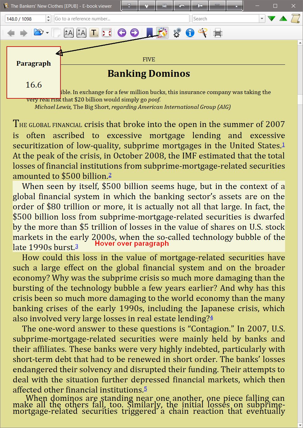

Paragraph numbers would be a more sensible option than line or page numbers.
The calibre viewer will display them if the Reference mode button is pressed, see attachment.
I am not aware of any way to get paragraph numbers injected into the epub itself, but that doesn't mean there isn't a way.
