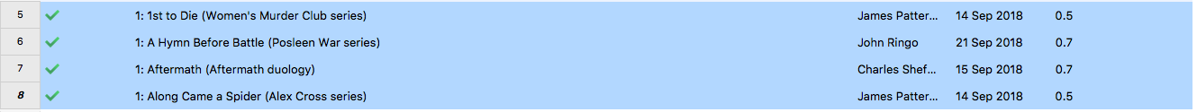

So I had set up the plugboard to properly add series info to my books before sending them to the Kindle Fire HD 8 (see attached image) but now the plugboard has stopped running so all that series info is missing (see image).
The third image is of the existing plugboard. Please tell me how to make the plugboard work permanently.
Thanks!

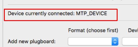

3rd image says you have 'A' plugboard, not what it does. For that, you need to select the plugboard: click edit (which populates the right side). Then we can see what in your screen capture
But I suspect it is the MTP device
What does Calibre say at the bottom whe the device is attached?
Change that MTP... to that

Actually it does show that the currently attached device is the MTP_DEVICE
Sent from my Nexus 7 using Tapatalk

Uh! Where. There is no status line in any of those shots.
The mention of MTP is just a configured plugboard
Old 10-07-2018, 12:26 AM   #5
Posts: 22,044
Karma: 30277960
Maybe PeterT means this
Old 10-07-2018, 12:40 AM   #6
Posts: 45,664
Karma: 28549046
MTP device is correct for the Kindle Fire HD. Hwever make sure you are sending azw3 not mobi to the device, since your plugboard is for azw3 only. Do a conversion to azw3 before sending.
