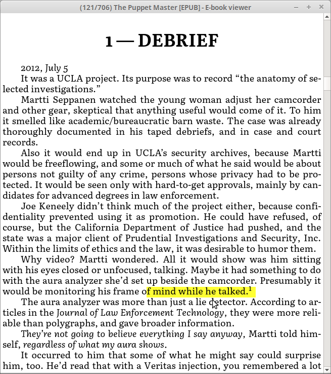

You will have to use the ebook editor, do not do during conversion.
See screenshot I find were a sup or sub is used, get the css property name see the highlighted areas in the File preview and text editor sections.
Name:	Screenshot from 2018-09-16 12-26-42.png
See screenshot two I go to the css file and edit the css property values.
Note these are just the general ones that I use, for some I will add font bold and letter spacing--example a linked footnote.
Name:	Screenshot from 2018-09-16 12-27-21.png
See screenshot three for what is looks like in the calibre ebook viewer.
Name:	Screenshot from 2018-09-16 12-28-42.png
bernie
