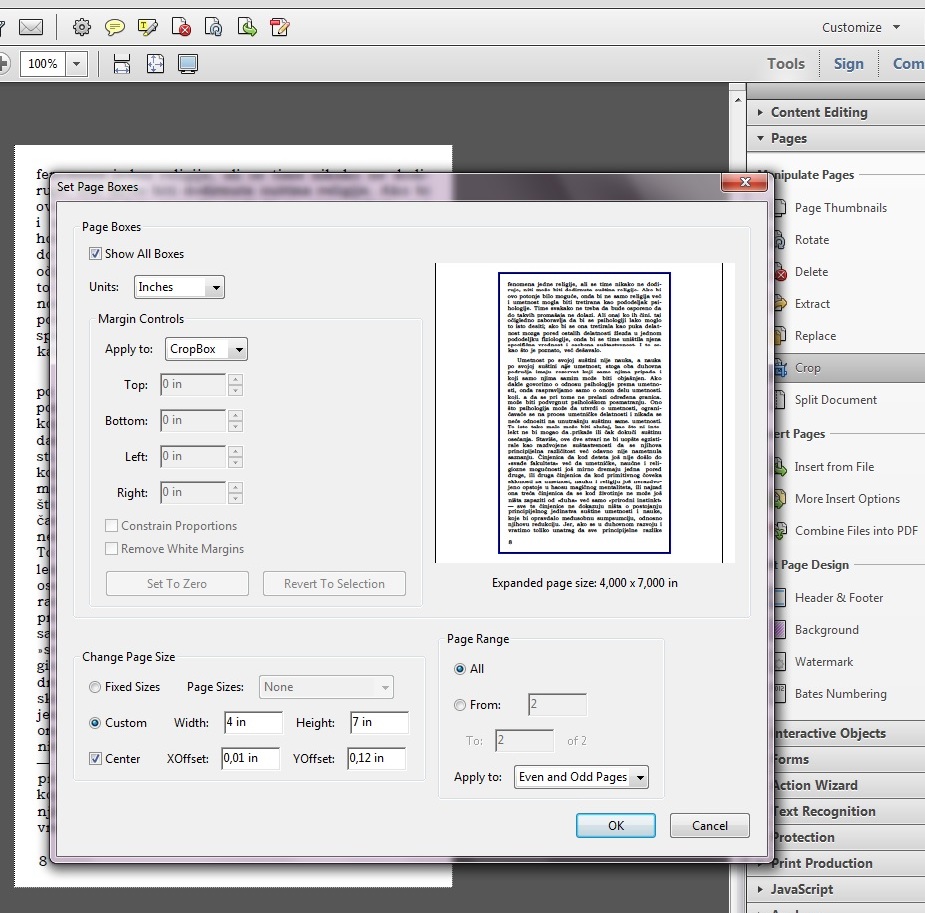

I don't have 13" Sony, but white margins are there IMO because you've been using fit-to-page mode or fit-to-page-height mode in your reader, wherein the shorter page is shown without the margins (both shorter 3.99/5.47 and the longer page 3.99/6.75 are at the same 3.99 inch width).
You should simply choose another reading mode if available, e.g. on Kindle DX (using koreader app) it would be fit-to-page-width or fit-to-content-width, but in that case it would also take two screens per pdf page for the longer 3.99/6.75 page(s).
If you want the page B (shown without margins) to be rendered as with margins, like the longer page A, you can use Adobe Reader's crop function i.e. the change-page-size function therein, or any other pdf editor with a similar page-size function, just quickly changing page size to 4 inch and 6.75 inch height for all pages, also choosing centered page.
It should take less than a minute for the whole pdf.
The shorter page(s) would look like in an attachement.
File Type: pdf Pages from the book- extra_resized.pdf (346.6 KB, 545 views)

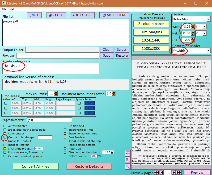

The issue with this particular PDF is that it is only 4 inches wide and you are reading it on a reader with an 8.25-inch wide screen. You can use k2pdfopt to create a new PDF where the source PDF is magnified to fit the width of an 8.25-inch page using the settings in the attached screen shot, or the command below.
k2pdfopt -w 8.25in -h 11in -odpi 200 -ds 2.5 -fc- -mode fw -ls- pages.pdf
The -ds 2.5 increases the size of the source document by 2.5x so that it effectively becomes 10-inches wide. The "-mode fw" then fits that text to the specified reader screen width of 8.25 inches. I've attached the result.
