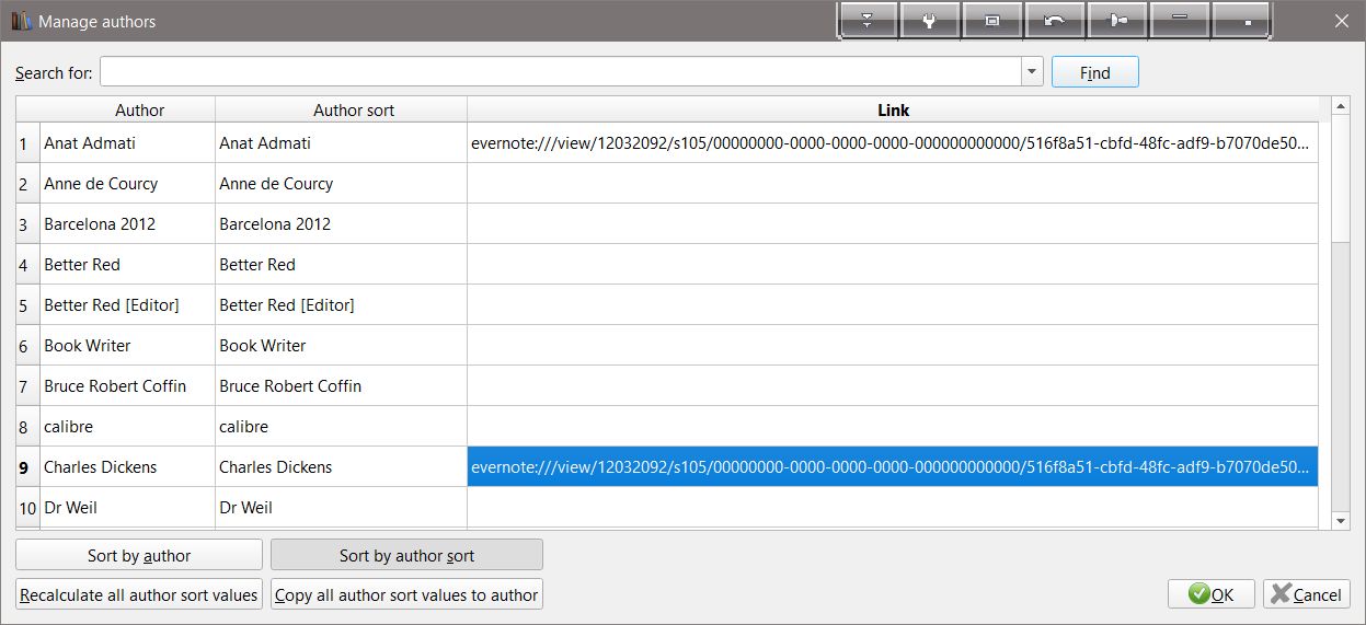

Originally Posted by pg111 View Post
However as it is info related to a specific author and not a specific book could you help in letting me know how to link the note not to Book but to Author so this info could be available from any book by the Author?
Put the EN Note Link in the Link cell in Authors entry in Manage Authors, viz:

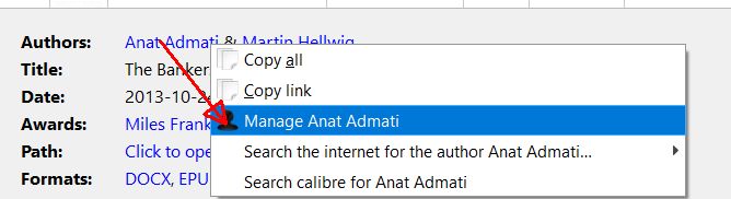

Easiest way to get to the Authors entry in the Manage Authors list is via the Author's right click menu in the Book Details panel, viz
Then when you click on the Author's name in the Book Details panel of any book by that Author the EN note for that Author will display.
