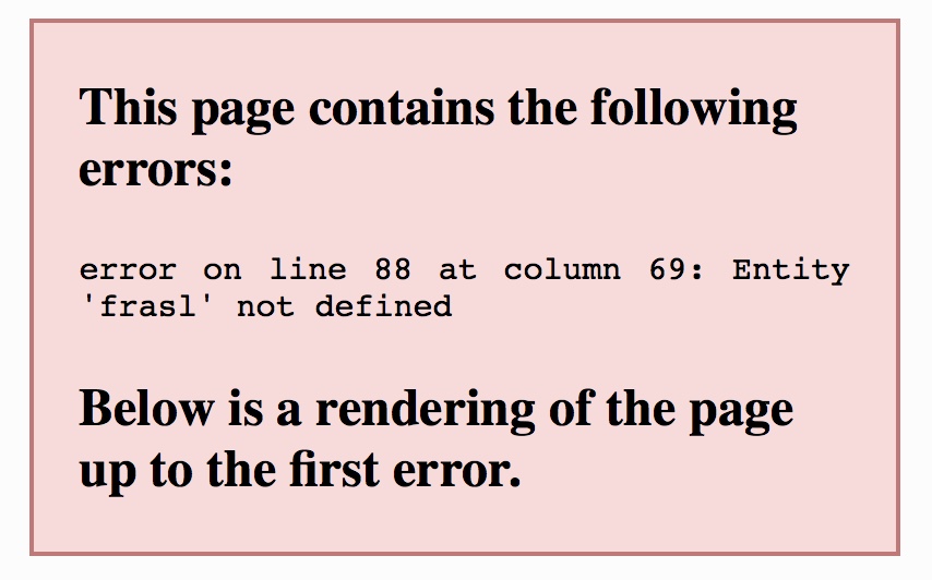

Hello forum
Im using the code ⁄ to generate a fraction with HTML in Calibre, its working fine in the preview mode (picture 2) but not the final EPUB-file. The code is (picture 1):
<p class="rightalm"><span style="font-size:70%;"><sup>7</sup>&frasl;<sub>3</sub></span> 1911.</p>
I get this error:
“This page contains the following errors: error on line 88 at column 69: Entity 'frasl' not defined Below is a rendering of the page up to the first error.” (picture 3)
Any idea what is wrong? and how to solve the problem so I can display the fraction symbol?
Regards Dan

Originally Posted by degn View Post
Hello forum
Im using the code &frasl; to generate a fraction with HTML in Calibre, its working fine in the preview mode (picture 2) but not the final EPUB-file. The code is (picture 1):
I get this error:
Regards Dan
What happens when you replace &frasl; with "& # 8260;" <remove the spaces>? AFAIR, the calibre editor removes the DOCTYPE declaration which is needed to use named entities in epub2 documents. With epub3 removing most named entities, I've gotten used to using numeric entities instead though they are a PITA since named entities are just so much easier to read. I seem to remember from a discussion 4 or so years ago, that the calibre editor would translate named entities to numeric or the actual character while stripping the DOCTYPE declaration but as I said, years back and I may be misremembering.
Using Sigil as the editor, if I remove the DOCTYPE declaration, I get the following error from epubcheck:
Col: 69: FATAL(RSC-016): Fatal Error while parsing file 'The entity "frasl" was referenced, but not declared.'.
whereas when I restore the DOCTYPE declaration, I get "No problems found!".
Just in case, what I am referring to as the DOCTYPE declaration follows after the ?xml line.
<?xml version="1.0" encoding="utf-8"?>
<!DOCTYPE html PUBLIC "-//W3C//DTD XHTML 1.1//EN"
  "http://www.w3.org/TR/xhtml11/DTD/xhtml11.dtd">
<html xmlns="http://www.w3.org/1999/xhtml">
Last edited by DNSB; 07-23-2018 at 09:24 PM. Reason: fat fingered typos strike again! More at 11!
Old 07-23-2018, 10:08 PM   #3
Posts: 45,610
Karma: 28549044
Unless you have turned off entity replacement in the editor settings, typing &frasl; in the editor will simply give you the ⁄ unicode character which will work everywhere. Or use the Fix HTML tool which will automatically replace the entities for you in all html files.
Old 07-24-2018, 08:29 AM   #4
degn
degn began at the beginning.
degn's Avatar
Posts: 12
Join Date: Jul 2018
Device: iBooks on iPad Pro
Hi DNSB
replacing with & # 8260; worked fine, thanks.
degn is offline   Reply With Quote
