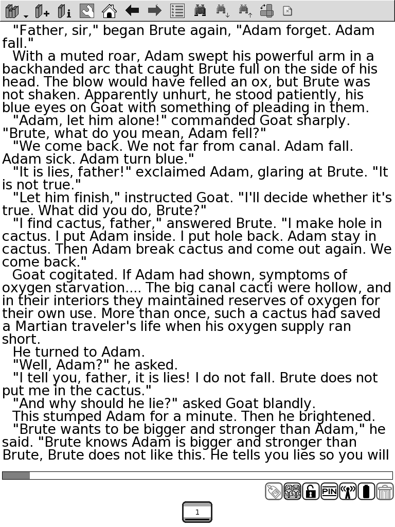

My port of FBReader is working well and is ready for users. Right now, the most difficult part is installation. I'll have to rely on someone else to put together an installation script.
With this method, I'm able to open up files supported by FBReader (chm,rtf,fb2,pdb,tcr,prc) directly from the content lister. The pagebar works, and the screen refreshes as it should.
Known Problems:
1) The first time you use the page bar, it may not respond. Simply press it again and it will work.
2) You will need to use the close soft-button in the upper right to exit. If you press one of the News, Books, Docs, Notes, hardware buttons, FBReader will be hidden in the background and continue running. You will need to close it through a shell, or restart for it to be closed.
Typical Disclaimers Apply. Do not install this unless you know what you are doing. Working in the root filesystem is very dangerous!! Is is possible (though unlikely) to brick your iLiad. I take no responsibility if you do so. Install at your own risk.
http://projects.mobileread.com/iliad...r/fbreader.zip

Hope you all like it. Below is a screenshot of it reading an RTF downloaded from ManyBooks.net

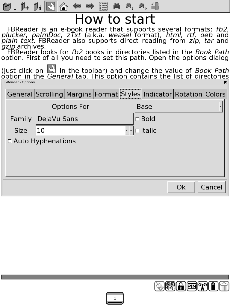

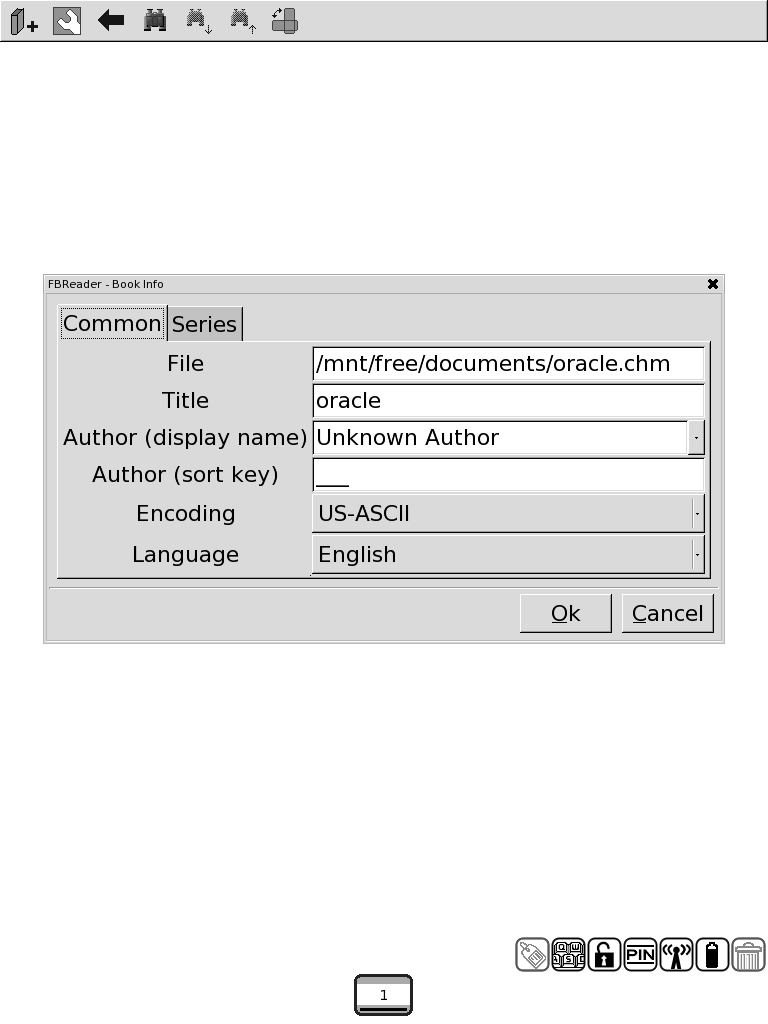

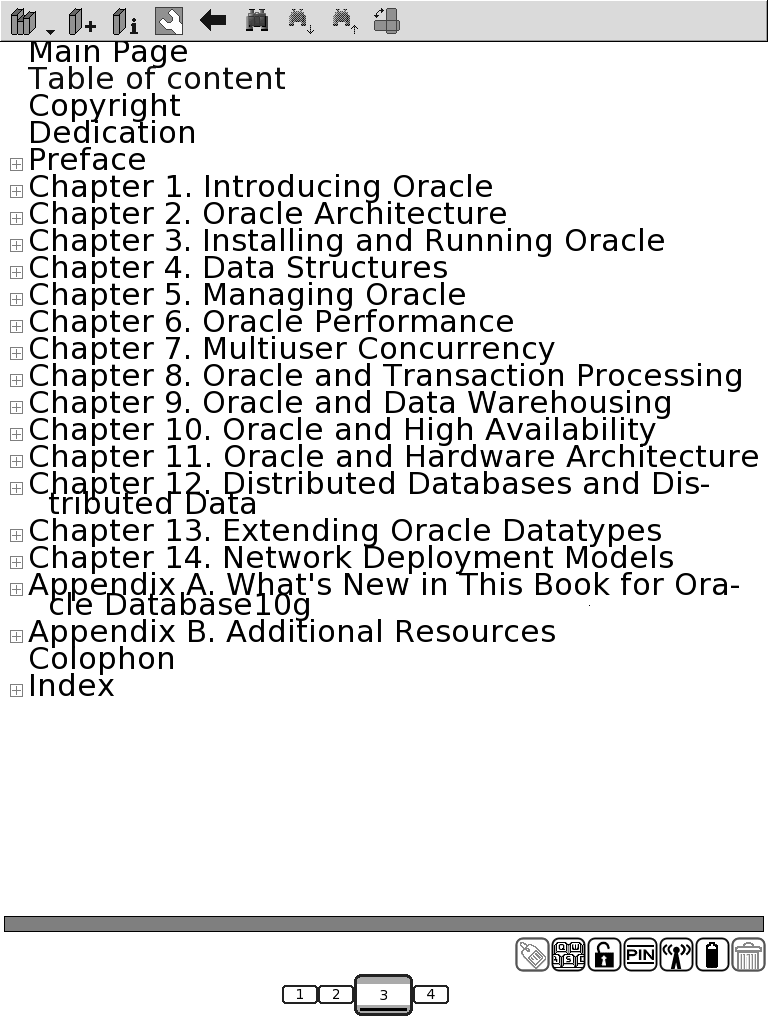

Even more progress (see attached).
Now comes the part where I may need some help.
1) Pagebar and buttons do nothing. They also cause the activity light to flash until the program is closed.
2) No option to close the program. I guess FBReader relies on the window manager to do it, but since we don't have a close button I don't know how to add this.
3) FBReader doesn't have the option that I can see to run from a dynamic location. The way I was able to get the icons and settings working, was because I made a symbolic link from /usr/local to /mnt/usb/fbreader. While this works for me, it's not practical for the average user.
4) I messed up my toolchain while testing. I'm using scratchbox. If anyone (*cough*Antartica*cough* ) has an up to date (2.9.1) toolchain, it would be great.
I may talk to FBReader developers to see if they can help. I'm sure they'd love to get a complete port to the iLiad.
Hardware buttons only works if the application in registered to th X server as "sh". In gtk1.x this is done with
gtk_window_set_wmclass(GTK_WINDOW(my_main_window), "sh", "sh");
In Gtk2 there should be some equivalent method. Searching a bit in Goocle, it seems that the wmclass is an attribute of the window in Gtk2 (no especial method, just ask for the attribute of wmclass), but I have not found any code example.
As for the flashing, there is a bug in muy patch to libX11.so that doesn't turn off the led. It should, as it tourns it off the first time, but then the same code stop working. Maybe it's that I cannot reuse some variables from one call to the next... but as I don't have a lot of documentation about the usage of liberbusyd, it's by trial-and-error :-(.

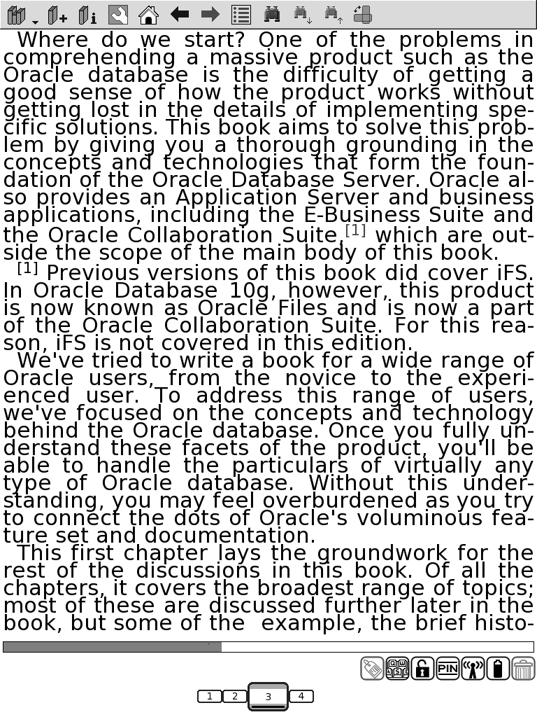

The close button was a simple enough addtiion. It doesn't have an icon, but that's alright because the default "icon missing" icon is an X. Closing gracefully solved the problem of settings not being saved. All of the functions seem to be working as well. I'll have to research the GTK wmclass issue. And yes, handwriting recognition does work for fields.
Right now my biggest problem is getting libraries/versions straight. Sometimes the screen doesn't want to update by itself after selecting something. I'll have to tap again in a blank area to get it to update.
Overall though, I don't see why this shouldn't eventually be very useful on the iLiad.
After executing fbreader, you should have a file named "iliad_refresh.conf". It contains the timeout for updating the screen after having detected some message passing betwen the program and the X server (that file is created by my patched version of libX11.so). Edit it to have a larger value (it's in milliseconds), and test if the problem disappears.
