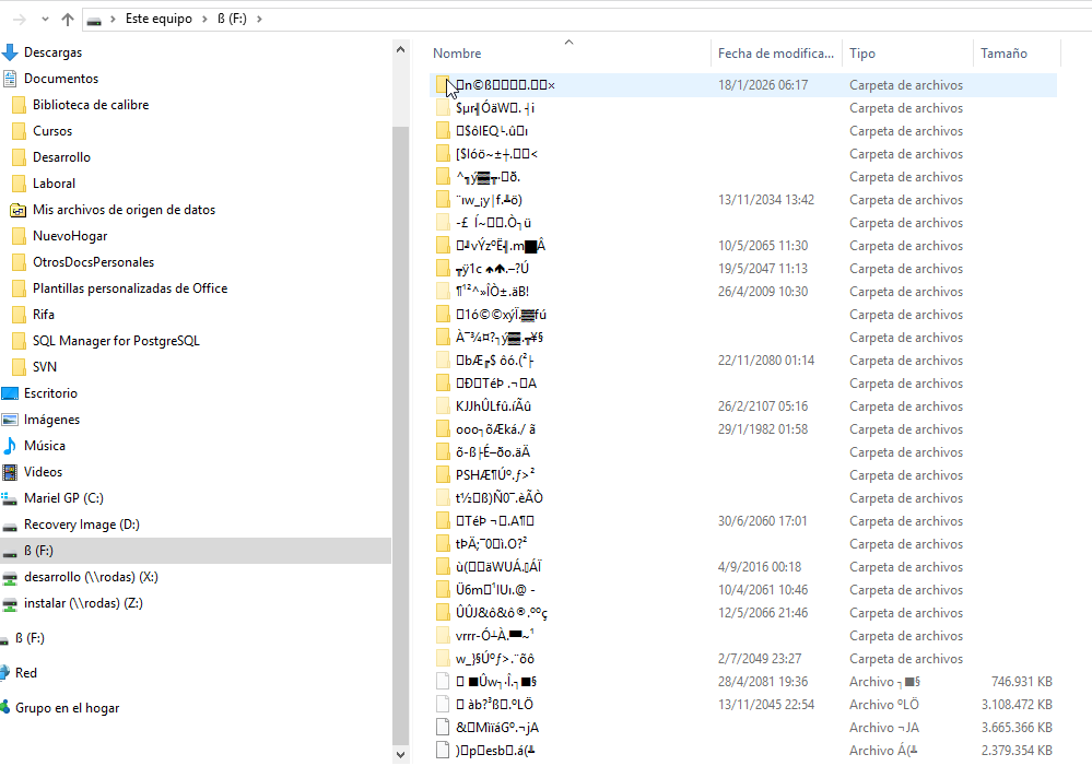

marielpq
marielpq began at the beginning.
Join Date: Oct 2019
Device: Nook Simple Touch with GLowLight
My books desappeared too with Calibre ....
.... when I added new ones.
I restore my Simple Touch with Glow Light, and the everything was OK, but when added new ones, the same
And when I watch the content in my windows PC explorer directory, I watch strange symbols, all are corrupted (look at the attachment).
Any ideas???
Thank you!.
Mariel
