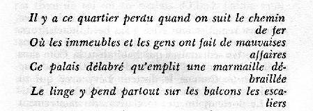

I am looking for the CSS code I could use for looong verses like the ones in the joint screenshot.
Thanks for any help.

I think you need to look at using "direction" -
This looks like it will get near to what you are looking for :
<p class= "poem"> A bunch of the boys were whooping it up in the Malamute Saloon </p>
<p class= "poem">  The kid that handled the music box was hitting a ragtime tune </p>
 <p class= "poem">Back of the bar, in a solo game, sat Dangerous Dan McGrew,</p>
<p class= "poem">And watching his luck was his light-o'-love, the lady that's known as Lou.</p>
with the following css style:
.poem {
  text-align: justify;
  direction : rtl;
  text-indent: 0;
This though gets messy handling the second comma on the third line.
BobC

Sorry to be a buzzkill, but that's not going to work. That text is not, in fact, reading RtoL; it's reading Left-to-right, like all Euro-based languages, and the line wrap is simply right-aligned, nothing more nor less. if you use R2L, the text will, indeed, read R2L, not merely flush-right line-wraps.
It is too bad that text-align-last: right isn't well supported.
Yeah, it's not supported at all, afaik, other than maybe in ePUB3.
This sounds like yet another case for client education.

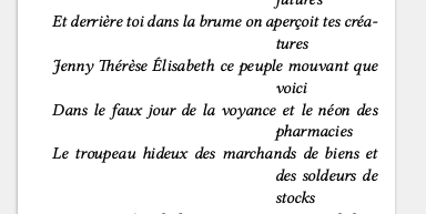

Well, this is what I decided to use.
Each verse has its own paragraph style (Chanson) and the stanza is kept within a div (space) tag. As the length of the verses is variable, I could not find a perfect solution and had to compromise. I tried this one on a six inches screen, it should possibly be better on wider ones, and dubious on smartphones.
I made use of a negative indent which seems to be correctly supported for ePub and PDF. A screenshot is joined. No idea for others (hello Hitch!).
p {
  display: block;
  margin-top: 0;
  margin-bottom: 0;
  border: none;
  padding: 0;
  text-indent: 1.5em;
  widows: 2;
  orphans: 2;
p.Chanson {
  margin-left: 70%;
  margin-right: 0;
  margin-top: 0;
  margin-bottom: 0;
  border: none;
  padding: 0;
  text-indent: -65%;
  font-style: italic;
.space {
  margin-top: 12px;
  margin-bottom: 12px;
