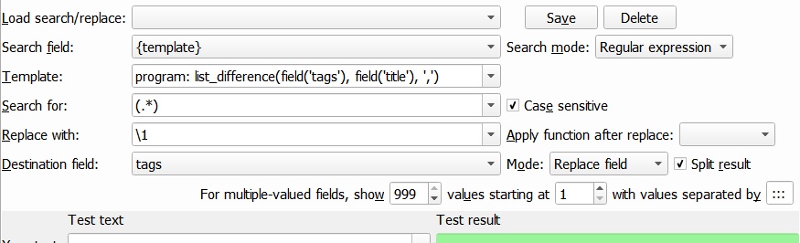

Originally Posted by wjBLqf-_9 View Post
Unless there is a way to search tag fields for that book title (programably for each book)
Use bulk metadata edit search and replace in template mode. The following will remove any tag that equals the title as long as the title does not contain a comma. If the title *does* contain commas then the results will be incorrect and quite possibly bad. Hint: search for books that don't have a comma in the title and apply this S/R to those.
The text of the template is:
program: list_difference(field('tags'), field('title'), ',')

So maybe my search-and-replace code "kung-foo" isn't as sharp as I wish
Using that search-and-replace window somehow managed to embed the title of the book ... within the tags of the book
in most of my library of 7,000 books
Honestly, I'm shy about using that window again unless I preface it with a filtering of book selection in the main window ahead of time
