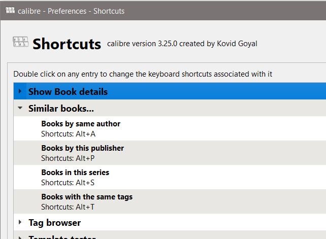

Press Alt+A
Also see Preferences->Look and Feel->Book Details->Clicking on author names should: setting

Yes, press the Alt+A key combination when the book is selected in the book list.
Originally Posted by C-novice View Post
I wasn't able to get that screen @BetterRed; however, I find when I right click on the author's name in the book details panel, I get a few options; among them are, 'manage (author's name); 'search calibre for (author's name)'.
The screen shot I posted shows the Keyboard Shortcuts for Similar books, its one of the Preferences dialogues.

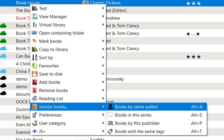

If you don't have or don't know how to use the keyboard then right click the book in the book list, and then select Similar books->Books by the same author, viz:

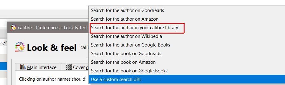

What happens when you click the author link in the details pane is controlled but the preference: Look & Feel, Book details and then the first item. One of the choice is "Search for the author in your calibre library". The others are searches for different sites.

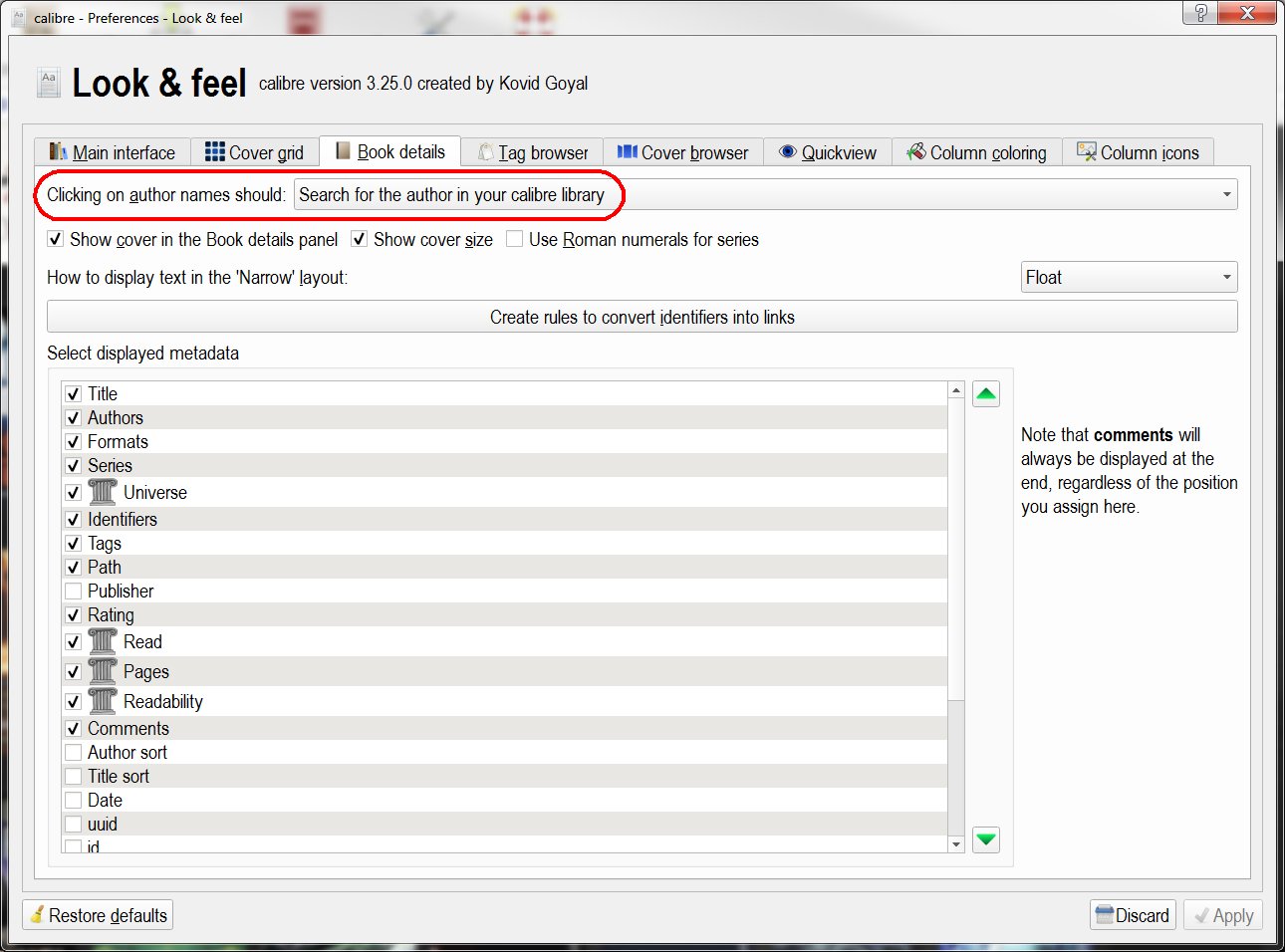

And the one that's been missed is...
That's the first place I looked, but like the man on the stairs it wasn't there. I suspect I expected to see it as the first or last item.
Funny thing is, it is the first item. Glad you have it sorted out now.

It's running in third place down here sport, viz:
