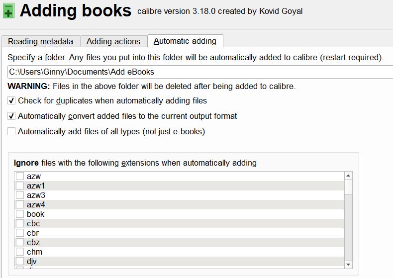

In Preferences under Adding Books, I've setup a folder in which I used to be able to put ebooks for automatically adding to Calibre. This function seems to no longer be working. I've even tried setting up a different folder for this purpose to no avail.

@Ginnia - check the Preferences->Add Books>Automatic adding (tab) settings.
Is the file type your trying to add checked in the Ignore list
If the file type is not a 'known' ebook type (those in the Ignore list) then you need to check the Automatically add files of all types (not just e-books) setting.

The book types I add to my auto folder are either AZW3, MOBI or ePub, and none of those is checked -- in fact no types are checked. This used to work just fine, then with early 3.x it seemed to stop working. I even set up a different folder and changed the Preferences accordingly, but nothing. I do have a space in the folder name, but the original folder also had spaces in the name. I have v3.19 currently installed. I generally don't update every release, but have been doing so, (only skipping one or two releases) hoping the problem world magically clear itself up, but hasn't. Attaching screen shop of me Preferences..

Just for kicks, I shutdown Calibre, and then restarted it -- the book I had placed in my auto folder loaded into Calibre on restart.

That means something is blocking calibre from getting notifications when the contents of the auto-add folder are changed. You can run calibre in debug mode and you might get more info in the log, but most likely this is happening at a level below calibre, in the kernel.
