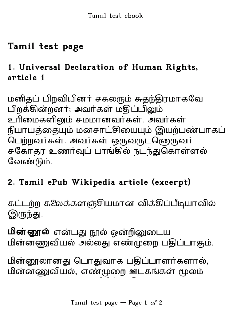

Originally Posted by SabaEdge View Post
I have seen Kindle touch and Kobo touch. Which one comes with tamil fonts? Which one has more compatibility for tamil books? It will be nice if some one can give some idea on this.

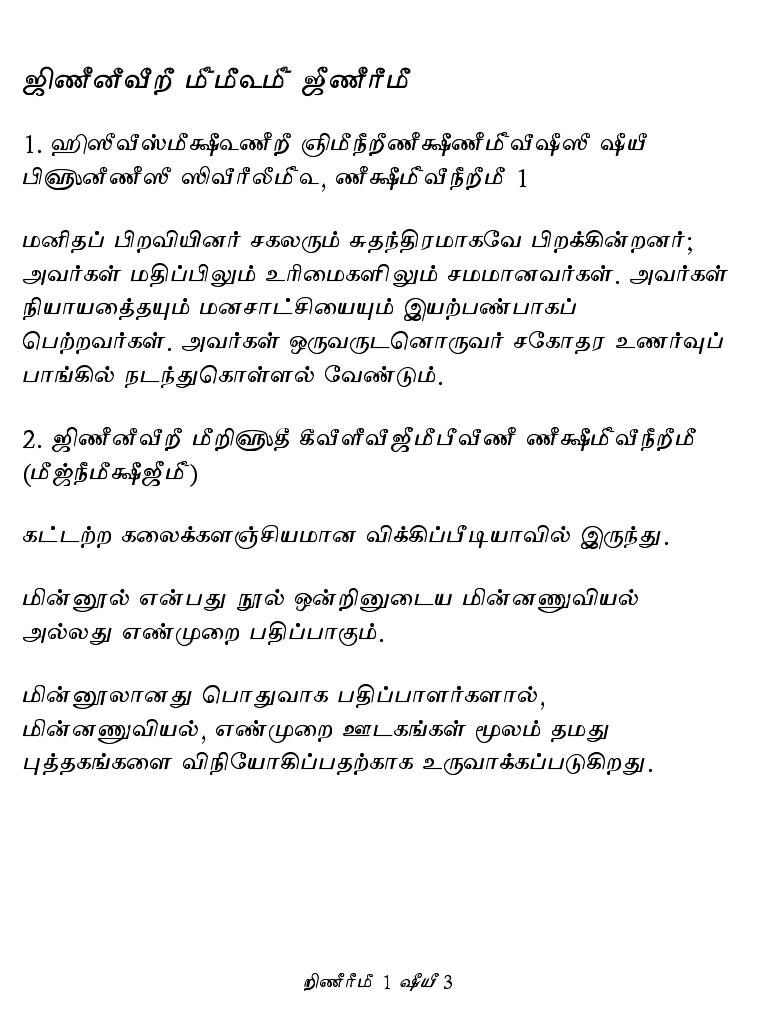

All Kindles come with the code2000 font, which also covers Tamil. However, I don't speak Tamil and I don't know whether Kindles handle all Tamil vowel signs correctly.
Have a look at the screen capture that I took with my Kindle PW2 and verify the proper placement of vowel signs that are being displayed left of the base letter. If the Tamil text is displayed correctly, your father would have to convert all his ePubs with Calibre to the AZW3 format. (Not the MOBI format.) Note that you can't embed Tamil fonts in Kindle AZW3 books.

Rendering Tamil requires more than just embedding a font, because some Tamil letters have vowel signs that logically follow a letter but need to be displayed left of the letter that they refer to.
I added an epub file with an embedded Open Source Tamil font (Tamil_test_ebook_ttf_epub3.epub) that you can use to test Kobo Tamil support. AFAIK, you might have to change the file extension to "kepub.epub."

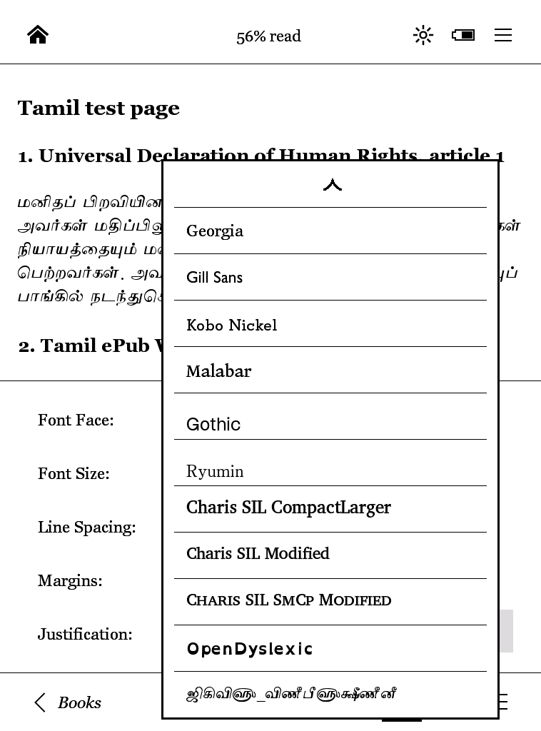

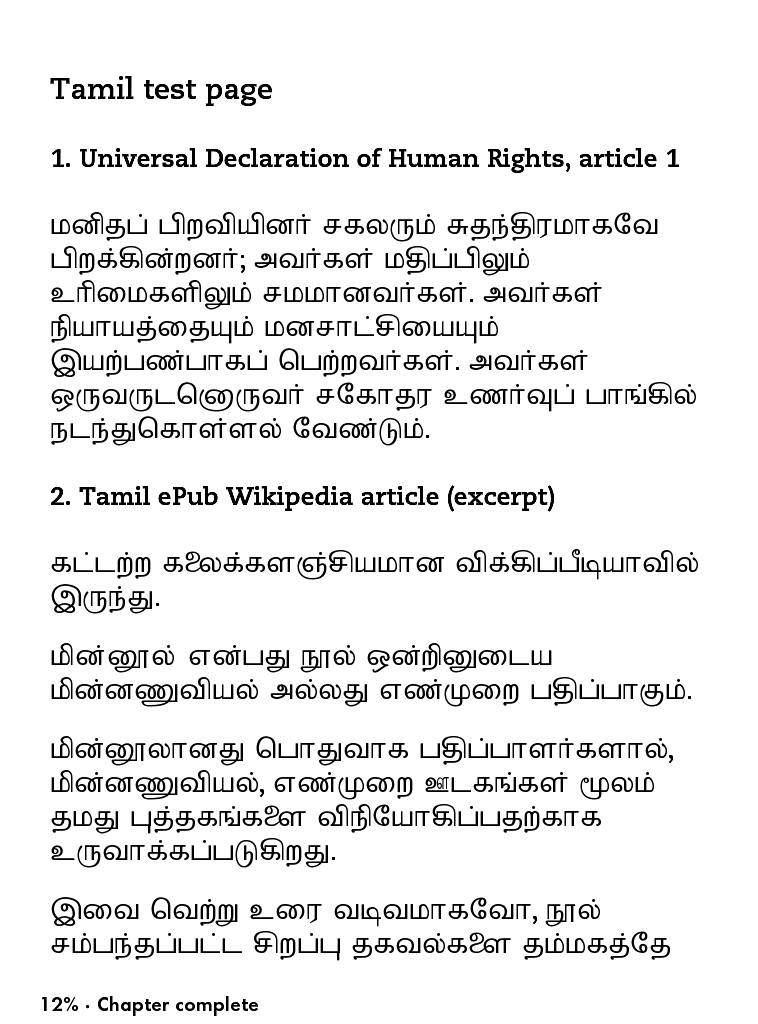

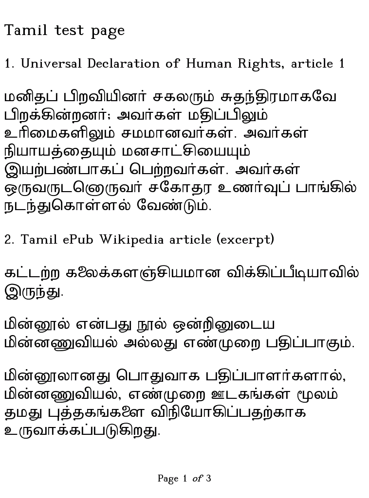

It seems to work. I loaded both epub and kepub versions of the book as I was expecting the kepub to work better. They both seem to be fine but I can't tell if the characters are in the right order. I also extracted the font and sideloaded it to test and it seems to have worked as well.
I have attached some screen shots:
- kepub using internal font
- epub using internal font
- kepub with the font menu displayed
- epub with the Tamil font selected
The last one was just prove it worked, but the English text is replaced as well.

All current Kindle models come with this font (code2000). However, you could also install this font on a Kobo. (It used to be a shareware font, but is now in the Public Domain.)
I.e., if you're otherwise leaning towards Kobo ereaders, you could install the same font or even a better one. (You can't install Tamil fonts on current Kindle models.)

Yes, the Kindle version seems to have better contrast. My guess would be that it is the different font. As suggested by Doitsu, I'll try installing code2000 tonight and see what difference that makes.
I forgot...
There is an option adjust the weight and sharpness of the inbuilt fonts on the Kobo devices. This doesn't work for sideloaded fonts, but someone has created a patch to enable it. All the reports I have seen say that it works well.

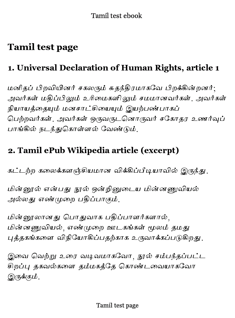

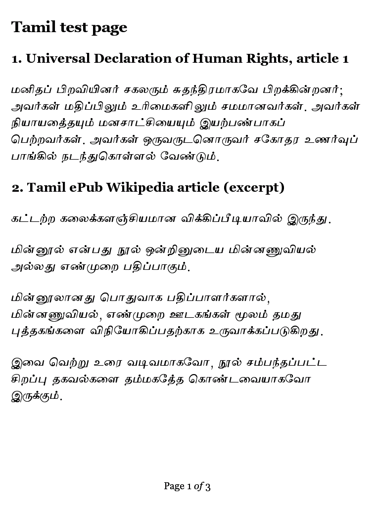

OK, here's some screenshots with Code2000 loaded. One is the epub and the other the kepub version. Both have Code2000 selected as the font. These look more like Doitsu's Kindle shots, but they look thin. And I don't know why the titles in the epub version aren't bold.
Edit: After posting the screenshots and looking at them in the browser, they look a lot closer to the Kindle versions. I should have use the same viewer to get a better comparison.
Thanks for taking the additional screen captures.
They aren't bold because the Kobo apparently used code2000 for them as well and code2000 doesn't contain bold glyphs.
In my screen capture only the Tamil text was displayed using code2000; the headings were displayed using the default Kindle serif bold font. (Unless otherwise specified, Kindles select fonts based on Unicode ranges; only glyphs not available in the Latin and CJK default fonts will be rendered using the code2000 Unicode fallback font.)
