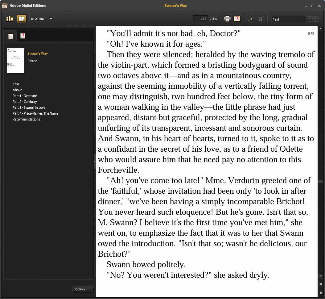

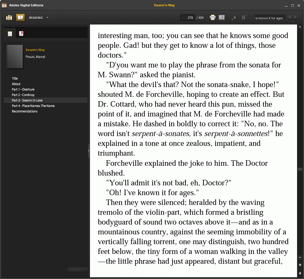

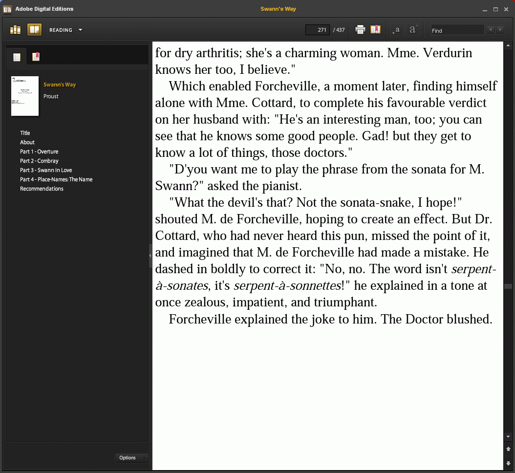

I enclose screenshots of Adobe Digital Editions for the original FeedBooks version and the split any2epub version. Note the awkward forced page break - fortunately only three of these are needed for the entire ebook.
