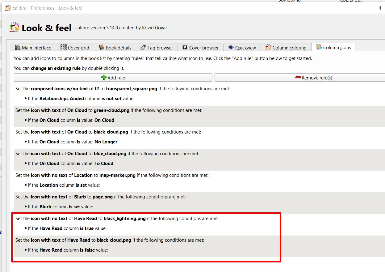

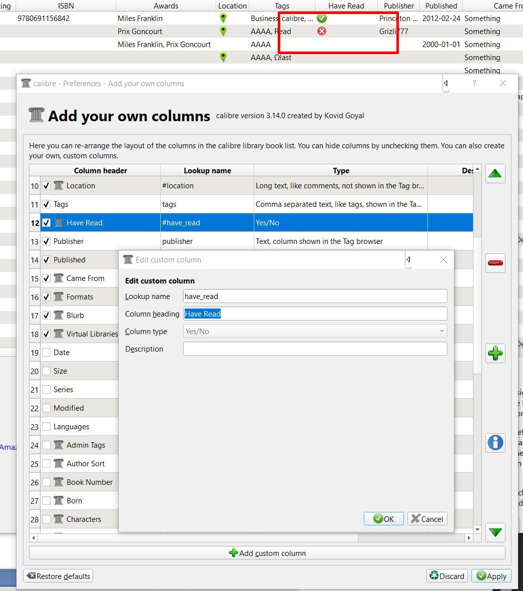

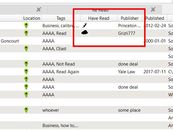

Originally Posted by Jo69 View Post
Thanks.
Sounds easy when you say it but confusing for me sorry
Is it possible for you to show me with attachments maybe?
Sure
First I set up a have-read/Have Read column which is type Yes/No, then I entered 'Y' in that column for the first book, and 'N' for the second book. By default the column is displayed as a 'green tick' and a 'red cross' respectively.
But let's assume I don't like the green tick and red cross, perhaps because I have several other Yes/No columns, so I decide i want my have_read/Have Read column to show a black lightning bolt for 'Y' and a black cloud for 'N'. Here are the column icon rules to do that:
They are simple rules. One could combine the two rules into one via a template, but that would add obscurity for the sake of brevity.
And here is the result:
Hope that helps.

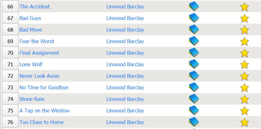

My Calibre looks very colourful now.
Jo69 is offline   Reply With Quote
My only problem now is, that when I click a yes/no in a column it now takes ages (maybe 10secs or more sometimes) to change to the new png I altered it to.
Have I missed something?
