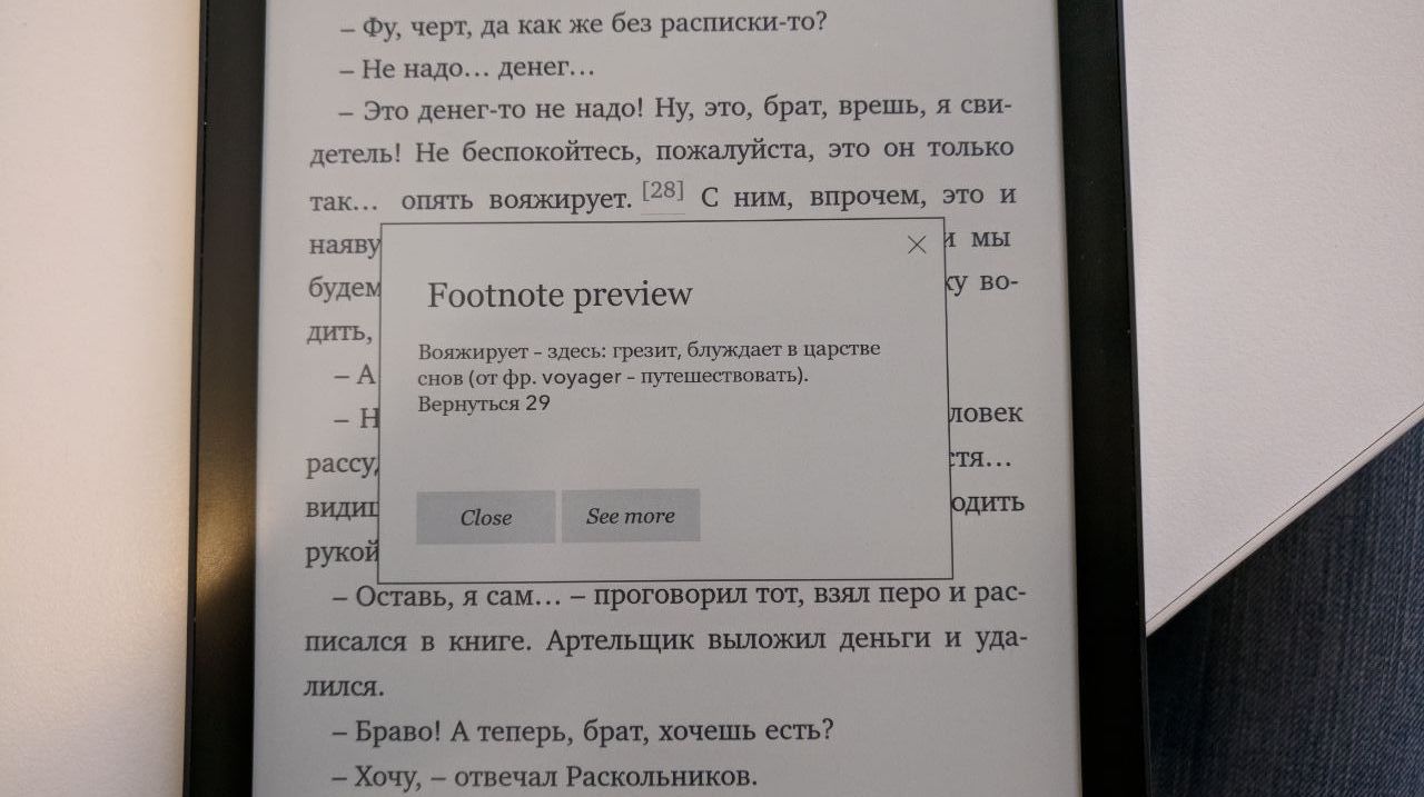

Does any way to set custom font for footnotes in KEPUB?
I was delete fonts by this patch:
#!/bin/sh
rm /usr/local/Qt-5.2.1-arm/lib/fonts/KBJ*
But now I don't have problem with Cyrillic text, but Latin font is different.
Look screenshot? Is possible to fix this?
Maybe you should exchange the KBJ font with the font you want (giving the file name KBJ and also changing the denomination inside).
Good luck.

Vetchy,
all fonts removed (except Georgia)
Then it will show everywhere correctly, without distortion.
For reading I use Bookerly and Mediator Sherif.

Originally Posted by Semwize View Post
Vetchy,
Thanks, works fine.
