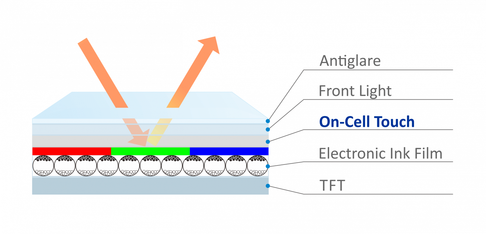

The thing I question is this only a color screen or is there a version without color?
This shows a color layer. There is no picture without a color layer.
Attachment 187356
The press release clearly mentions black and white:
In terms of optical performance, black and white ePaper display modules with E Ink's On-Cell Touch see a 30% increase in the contrast ratio of black and white content, providing readers with clearer text content. When used with E Ink Kaleido™ Plus, the color contrast ratio and color saturation increase by 40% and 15% respectively, providing an enhanced display for color eBook and eTextbook content.
They don't show a picture of the B&W screen but wouldn't look much different, just remove the colour filter layer.
