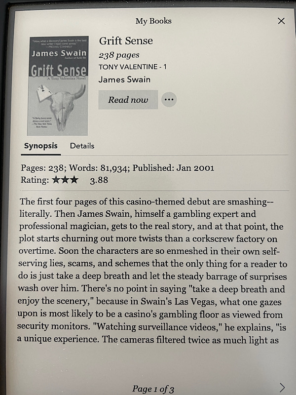

I tried that during previous experimenting. Just tried again to make sure, but it is still not working. Here is the entire plugboard:
kepub:KOBOTOUCHEXTENDED = ([{#pg_ct:|<div>Pages: |; }{#wd_ct:|Words: |; }{pubdate:|Published: |</div>}{#last_read:|<div>Last Read: |</div>}{#gr1:rating_to_stars(1)|<div>Rating: |  }{#gr1:| |</div><hr/>}{comments}] -> comments)
I added the numerical value from the same column so you can see the rating of 3.88 in the image. Only 3 stars show, where I assume it should be 3.5 stars.

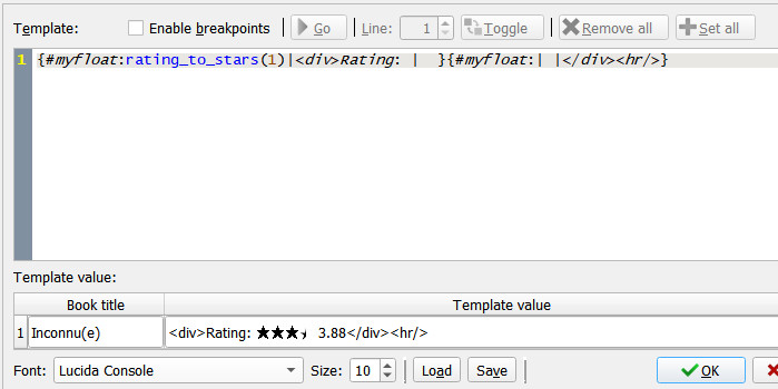

The function works. See this screen capture of the template being evaluated by the template tester.
My guesses are:
  • the book wasn't updated on the Kobo so you are seeing the old value. Edit: Clearly not the case since we are seeing the 3.88. Sorry about the noise.
  • the Kobo cannot display the 1/2 star character. What happens if you paste the 1/2 star character (⯨) (the character shows as a box on Windows Chrome) into the template like this (an image so the half-stars show)?

Your guess is correct. The Kobo Clara HD cannot display the half-star. I added the code for a half-star and a full star to the template, updated the Kobo, and got a blank space where the half-star should be, followed by a full star.
So I will just stick with the numerical rating, which of course is more accurate anyway.
The best thing that came out of this is the Template Tester -- which I had no idea existed (and does prove the star function works).
