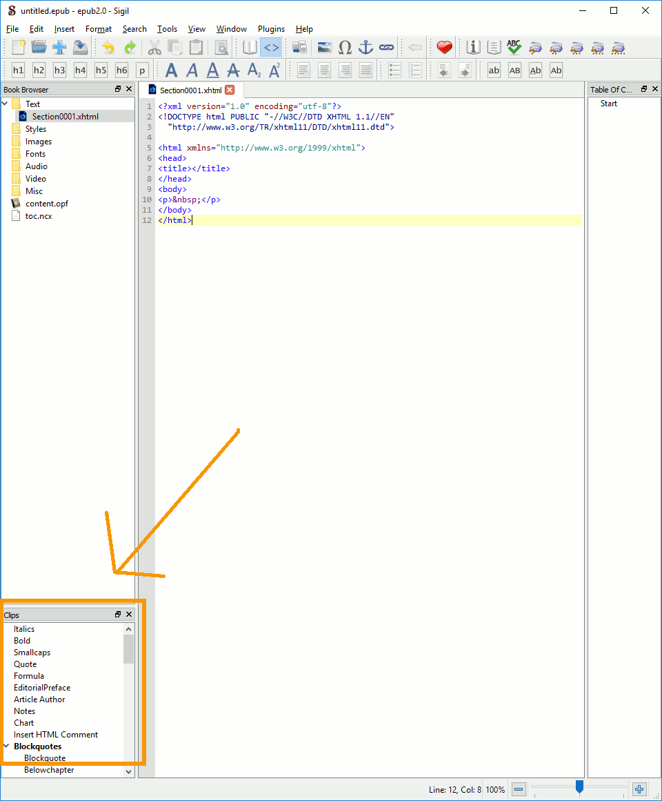

You could create a Clip using Tools > Clip Editor.
<div class="clear">\1</div>
and give it a name (like "Div Clear").
Then make sure you can see your Clips bar: View > Clips. I drag mine in the lower left corner:
now when you highlight text, you can press on the "Div Clear" clip, and it will wrap the div around it.
So this:
<p><img src="TestImage"/> This is a sentence.</p>
turns into this:
<div class="clear"><p><img src="TestImage"/> This is a sentence.</p></div>
