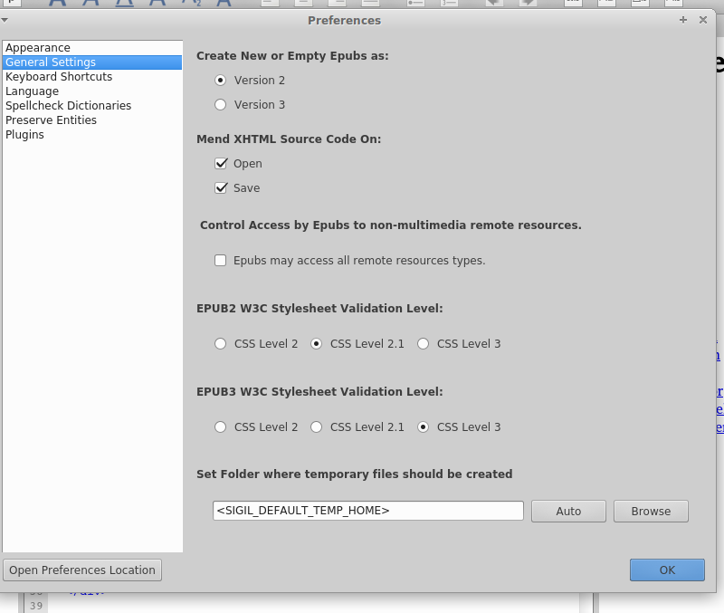

What does saving a "poorly formed" epub do?
I was working on an epub. Making a lot of changes. Doing the 'mend and prettify' option and saving a lot. Everything going along nicely. Then when I went to save one time I got a warning window saying the epub was not properly formatted (or something like that, maybe 'properly formed') and it said somethig about fixing it etc. and that I might lose some data. I Xed out of the window, thinking that would give me time to see what the problem was, but when I did, the bottom of the screen said something like 'epub saved but you may have lost a small amount of data.'
Questions:
1) Why did it save it when I just Xed out of the window?
2) What should I have chosen to not save it if I get that window again?
3) If I get that window again and get out of it without saving it, will checking the Tools>'Well-formed check epub' tool tell me what's wrong?
4) (and i realize this is unanswerable in a concrete way) What are the chances I lost a lot of data?
5) What is the typical data loss in that situation?
Thanks.

Are you sure there was any data loss at all? That warning was really a leftover from when Tidy was used. Are you sure any save was made at all? Have you checked the modification date/time on that file to be sure. Do you have the Mend on Save set in your preferences?
Wasn't there a Cancel Button on that warning dialog?
If you use Preview, it will show any well formed errors as you go. Yes you can use the well-formed check to find errors.
As for typical loss, I have seen nothing at all lost, and at worst a short piece of html code xml escaped and treated as text. Typically this is very easy to see.

Thanks Kevin. No, I don't know if there was any data loss.
Yes, I'm sure the save was made because at the bottom of the screen it said something like: 'EPUB saved but possibly with loss of data.'
(I tried to re-create the incident on another file but was unable to.)
I saved a bunch after that incident so checking the date/modification time won't help.
I'm attaching my preferences and confess I don't know what the most beneficial settings would be.
As I recall there was a Cancel button on the window. I guess I should've chosen that, but I thought Xing out of the window was the safest option and would essentially have the same effect as hitting the Cancel button.
And I was using Preview and saw no warnings there.
Good to know I can use the Well-formed Epub check to check for errors.
And good to know the data loss was minimal. And as I said, that's what the Save message said as well.

No, I just saw a window with the buttons and the ability to X out of it. There were no extensive details like you've shown. As I recall the window gave the option to "fix" the poorly formed stuff but I avoided that. And there were probably three buttons. Maybe "Yes," "No" and "Cancel."
I'd be curious to know what you think of my preference settings (I'll attach it again) and if there's anything I can do to make them work better for me. (I am a novelist and besides the cover and some images of other covers at the back of the book the epubs I make are exclusively text.)
Honestly, this is getting away from me a bit in regards to what my optimal preference settings should be and whether I should be should be using the
Tools>Reformat HTML>Mend and Pretify all HTML files
which I normally use a lot.
I never use the
Tools>Reformat HTML>Mend all HTML files
option.
Thanks.

I found the window that came up. And how it plays out:
Yes: It mends it and saves it
No: It saves with errors
X out: It saves with errors
Yes. The No is the default answer. You're not being offered a chance to abort the save--saving is a given. The only thing you can change is whether or not it Mends first. It's giving you a final chance to override your Save preference setting and not Mend the code first.
