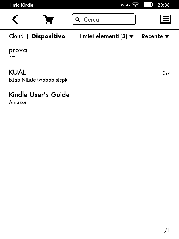

this is my html.txt page:
<html>
<head>
<title> DAJE </title>
</head>
<body>
<h1> SUKA </h1>
<p> test page </p>
<img src="world.jpg"></img>
<a href="http://10.10.10.1:3000/@signalk/instrumentpanel#anchor">Link Text</a>
</body>
</html>
on the kindle:
(cool but....)
attached screen shots
ID:	160189   Click image for larger version
ID:	160190   Click image for larger version
