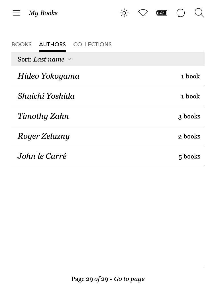

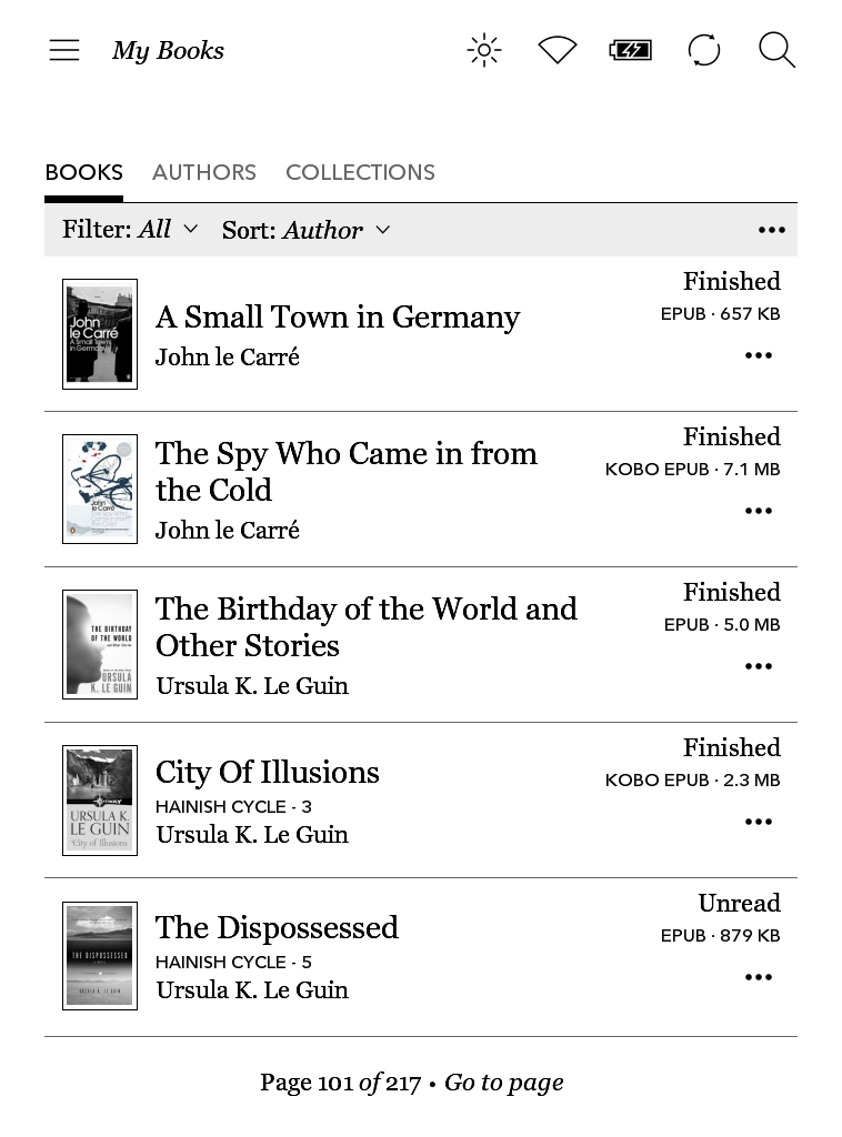

Well the mishandling of case-sensitivity and failure to recognise special cases like "jr." are what makes the Authors tab last-name sort broken. Every name can be made to sort correctly in the Books list, but there are some that can't be made to sort correctly in the Authors tab.
A real world example: "John le Carré" (with a hard space between "le" and "Carré") sorts correctly under L in the Books list, but sorts after Z in the Authors tab.
ID:	159706   Click image for larger version
OK. Your earlier post made me think you were seeing something a lot different to that. Have you reported your displeasure about this to Kobo?
