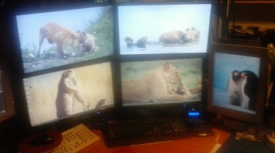

Did you rearrange them (position relative to the Main), either Logically or physically?
NB I run 4 (or 3) and it puts the window on one of the existing if the 4th is off line

1 is typically the Main (with start menu)
by rearrange,
was: 1 below, 2 above
now: 1 on Left, 2 right
was: 1 landscape, 2 portrait
now: both landscape
or you change a monitor size or resolution
