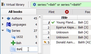

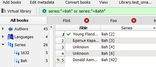

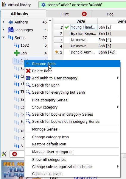

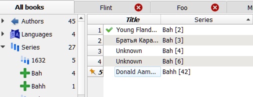

I just tested it myself. The four screen captures show that renaming the series "bahh" to the existing series "bah" did not change the series index of the book with "bahh".
EDIT: check the value of calibre's tweak "Auto increment series index (ID: series_index_auto_increment)". You probably want it to be set to no_change.
