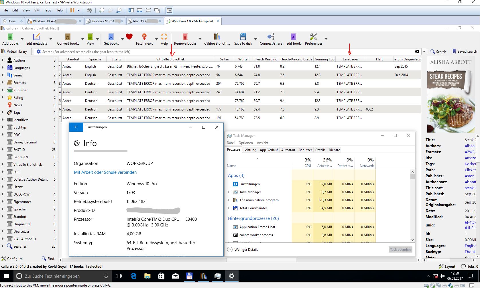

Hi chaley,
I setup a new Windows 10/64bit system with only calibre 64bit installed. I got the same error behavior.
Pls see attached pic.

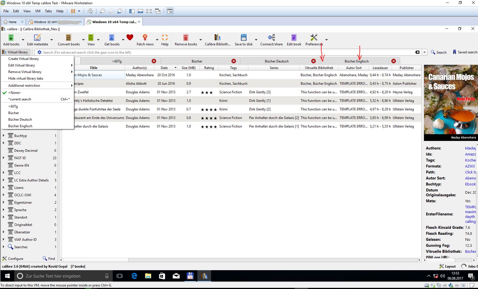

@chaley, I maybe find it...
I was wondering why I got the error immediately in a clean installation too. For me it have something to do how calibre is managing the searches. I use saved searches in VL's as well as searches defined by the VL-dialog.
I delete from the test library the files metadata.db and metadata_db_prefs_backup.json to get rid of all database setup, open calibre and told it to restore the database from scratch using its own metadata.opf files. After that the errors gone away, what do not really surprise me (as there are no searches available to provide the function with values. So the field was empty for each book.
Then I start to build up the VL's via create VL's manually again as they was listed in the dialogue for editing VL's. After I put in the forth VL search string the error came back again. (see pic)
I then go back and delete the last VL definition and the third after that too. and the error go away. After checking the search terms I think what's going on here.
I have two searches, one for books in German and one for books in English with following definitions in the test library:
languages:"=Deutsch" or "=German", languages:"=Englisch" or "=English"
After I changed this to
languages:"=Deutsch" or languages:"=German", languages:"=Englisch" or languages:"=English"
the test library works.
What makes me wonder is, why on one system this makes no difference and work fine and on a other systems the function crash and is able to influence other columns with definition "build from other columns" like I had it for the authors sort or calculation columns. In addition I know the old definitions was working for long time good. It seems like there is a little glitch in the chain. Maybe this will help to find out what happen with some installations to find the root cause.

I found the problem. I created a totally clean calibre configuration and the errors started appearing. The problem is that some of your virtual library search expressions use "naked" searches; searches with no column prefix. Example: Bücher Deutsch has the expression
Because the second term, "=German", has no prefix, calibre will search in every calibre column, including the composite column computing the virtual libraries. Because that column hasn't yet been computed, the searches for the virtual libraries are evaluated again. This causes recursion because the search will hit the composite column and start over again.
There are several cases in your VL definitions where you have a naked term. If I remember correctly they are all of the form col:value1 or value2. I am sure that you meant col:value1 or col:value2.
The reason I didn't see the error at first is that I have checked the box in Preferences / Searching that limits the fields searched by naked terms.
