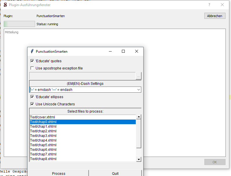

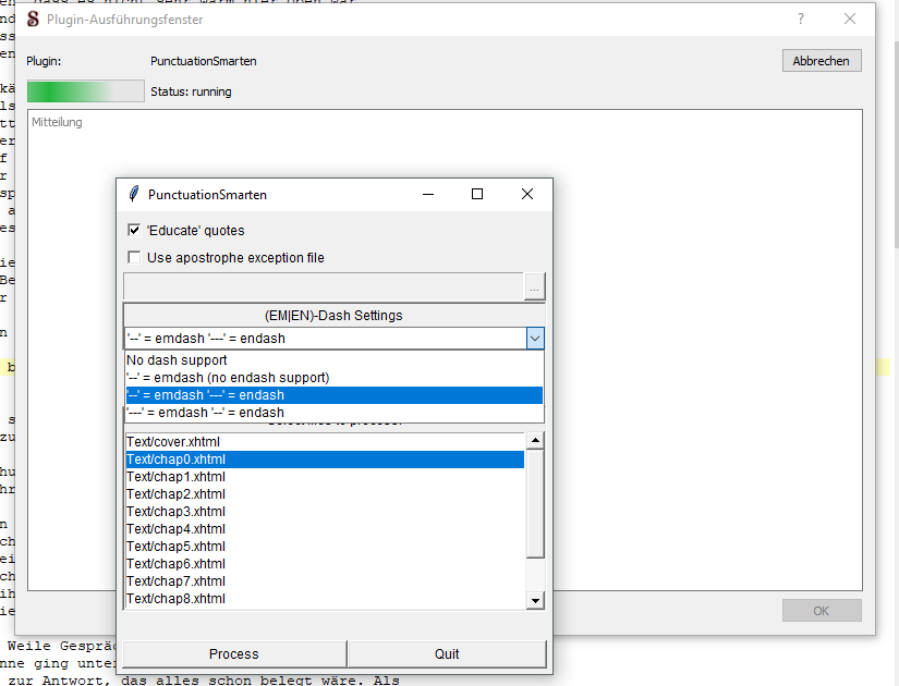

What must be set?

From the screen you have given us, select the files you want to smarten--Chap1 through Chap8, then press "Process." After a moment you will be told "8 files processed," click okay. Now you can do your search and replace on the new “smart quotes”, both the opening and the closing ones.
