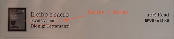

Anyway, on "My Books" list, by default the Title and the Author are shown by default. But I saw that some of the books uploaded in the last days also showed informations like Series and Index, that was very useful for me.
So I added the Series and Series Index entries also to other books and articles, but still they appear as before, only with Titleand Author.
I examined tha metadata on the ePubs showing such those additional info, but did'nt notice anything different from the other ePubs. Unfortunately, I removed them now, so that I can't post their metadata here, to help you deducing what makes difference.
In the end, do you know how to edit metadata so that Series and Index regularly appear in "My Books" list?

When I analyse the .epubs metadata inside my Aura One (I created a folder on my own), I see that they mantain informations also about Series, Index and other entries. But in the "My Books" list I can't see these additional details in evidence; I mean, sometimes I saw them, in the past, but I can't understand the logic under that showing/hiding, to replicate it.
I thought that using "Send to the device", in Calibre, erased the metadata, but I tried and verify: still the metadata own to the .epub .files. Another trying was to copy the .epubs directly to my Kobo pesonal folder, bypassing Calibre. No additional Series/Index metadata showing, neither in this case.
This wondering came only because I saw a couple of books showing such these precious additional infos, last days, and I would like to understand how to make them to regularly appear.
It would be great if I could use them to better describe the news articles and reportages I convert to .epub format from the Web: for example, in case of giornalistic reports consisting of multiple chapters, or several different posts from periodic columns. I would see the articles listed as follows:

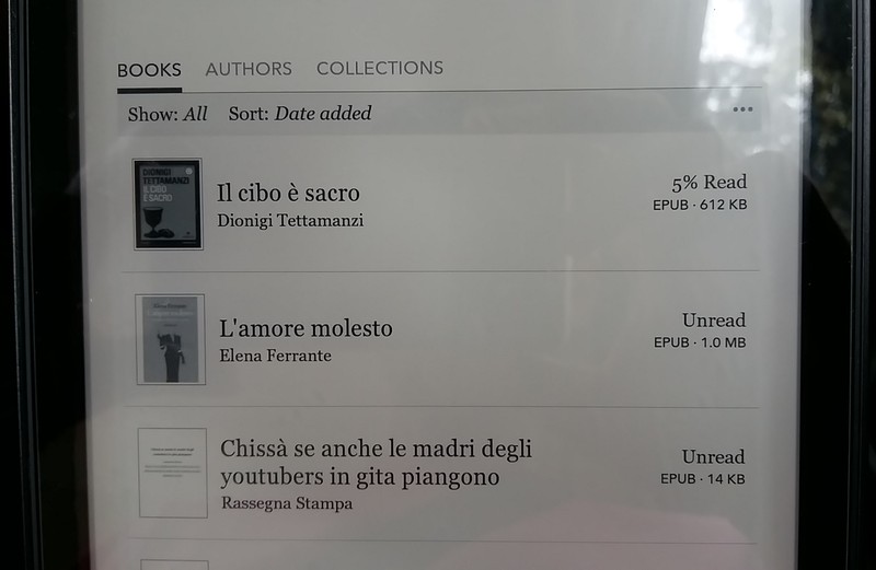

Still no metadata except from Title and Author...
Thank you Terisa and davidfor for your replies, and sorry for such a long time in mine.
I spent these days trying to better understand this matter of the metadata in the Aura One, and following your suggestions.
Sadly, I haven't found a solution yet: still I can't see other metadata in "My Books" list than Title and Author.

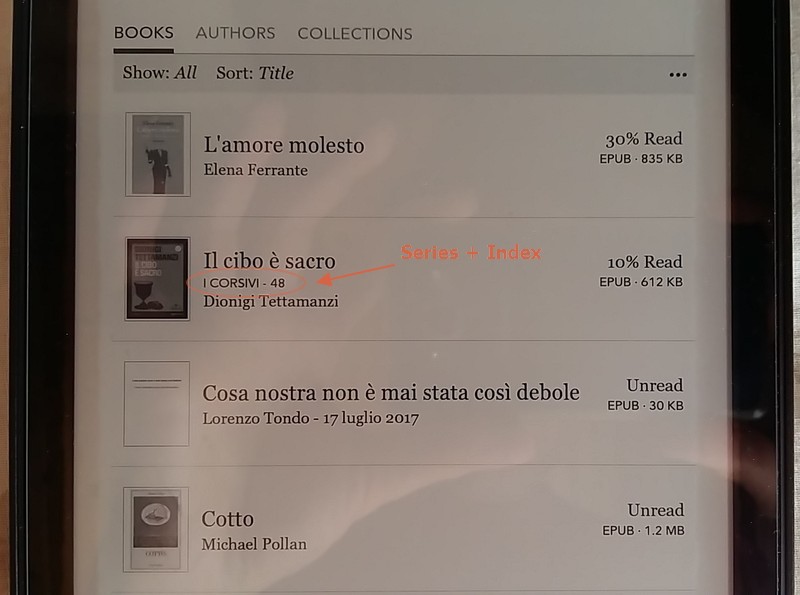

And it's strange, because these epubs do contain further metadata like Series and Series Index, that in some cases were shown, some weeks ago. In particular, I remember Il Cibo è Sacro by Dionigi Tettamanzi, Series i Corsivi n. 48, that I could view as follows, till some weeks ago:
And such a view was fine and useful, for me.
Then, after I made some changes, to make tests, Series and Series Index disappeared in the List also for this book. But still its metadata contains these entries, so I can't understand the reasons of the disappearing.
I edited metadata both 1) through Calibre and 2) bypassing it, making use of ePubMetadataEditor instead, a very very useful utility. In both cases, no success.

If you are not seeing the series info on the device it means one of a few things:
- The calibre configuration is not correct.
- The book does not have series information in the calibre library.
- The device has not been connected to calibre since the book was added to the device and processed by the device.
- When the device is connected to calibre, the book is not matched to a book in the library.
- Something is broken.
Based on my experience here, the most likely reasons are the first and the third.
The important thing is that the device does not read the series info from the metadata in the book file. The series info is not standard epub2 metadata. Hence, editing the metadata in the book with other tools won't help. The driver used by calibre to talk to the device updates the series info directly in the database on the device. Once that is done, and the driver is configured correctly, the series info will be displayed in the library lists on the device.
So, check the configuration. The driver needs to have the series info option set. Right click on the device button when the device is connected and select the configure menu item. The configuration dialog will be opened. Go through the options on the various tabs and find the series info option and make sure it is checked. Then go into the calibre preferences to the "Sending books to device" page. At the top is make sure that "Metadata Management" needs to be set to automatic. The next time you connect the device, the series info will be updated for all books on the device that match with books in the calibre library.
If the above doesn't work, I need to see a debug log from calibre.
