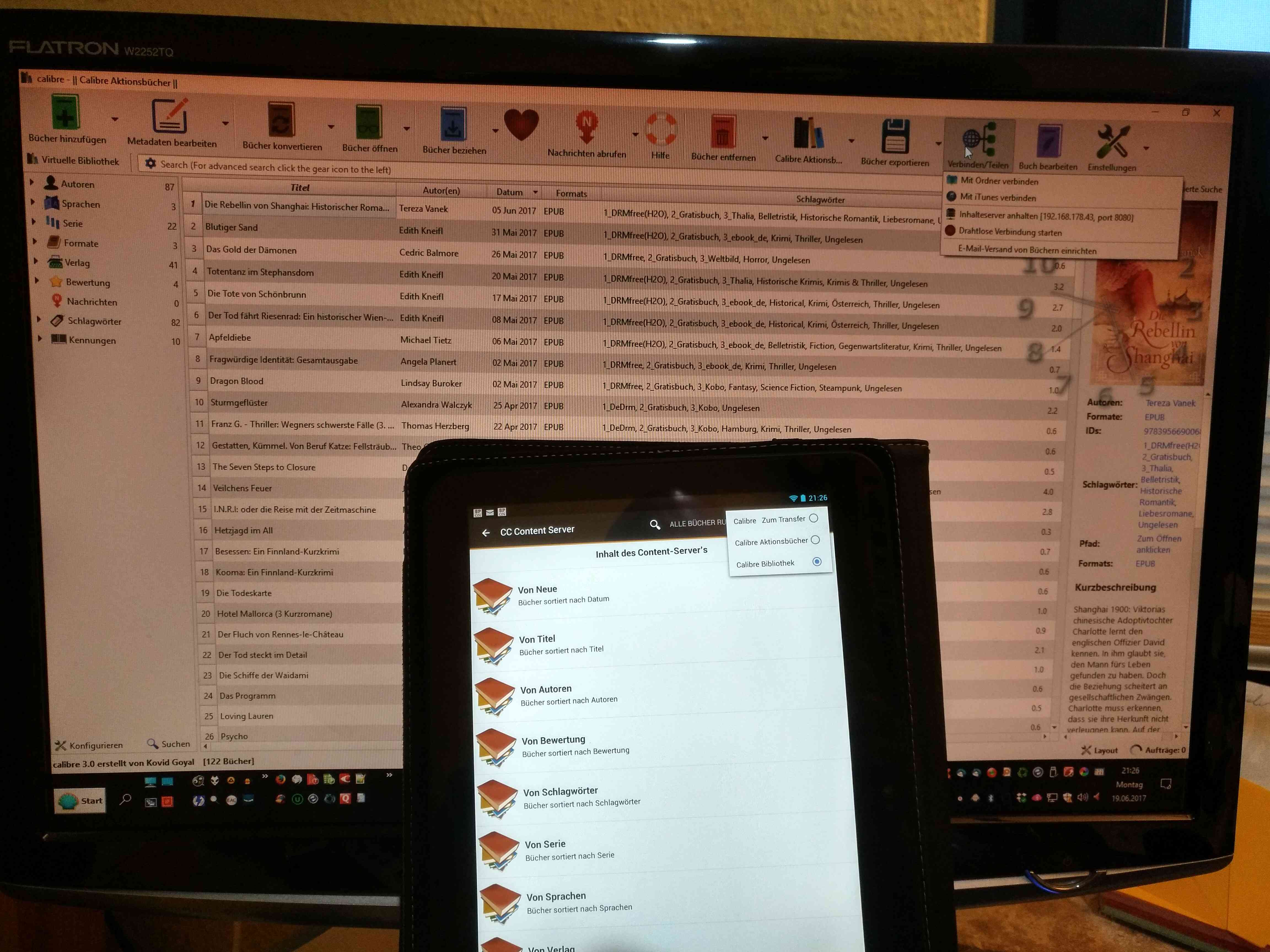

Since I use Calibre V3 i can't change the libraries for upload.
As you see in the attached picture, CC identifies the libraries but it sticks to the main "Bibliothek".
To find a solution i reinstalled the CC app and I moved from Calibre Portable to an installed version. Nothing changes.
In the portable Calibre are more libraries and I can use some, but not all.
What is the reason?
Regards Herbert

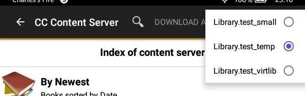

If on my test system I tap "Change Library" then I see the following:

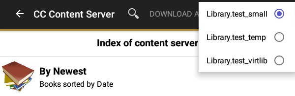

I can then tap the library I want, in this case the second one, in which case the library changes. After I do that then I see the following:
and I am looking at the books in the second library, exactly as I expect.

If you are saying that you are not seeing all the libraries on your computer then the answer is "you are seeing all the libraries that calibre knows about." CC asks calibre for the list of libraries. Calibre gives back to CC the libraries that are on the calibre "quick switch" menu. There is nothing that CC can do about that. Instead, you mist be sure that the running instance of calibre has all the libraries of interest in its library change menu.
As for discrimination, CC uses what calibre gives it. Calibre does not like path names with non-ascii characters in it, and never has. Again, there isn't anything that CC can do about this.
