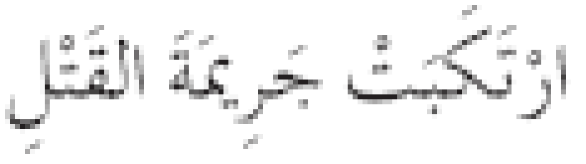

One of my ebooks contains many .png images of Arabic text that was saved with a relatively small font size (most likely 11 or 12pt), which makes it really hard to read. (For an example, see the attached file.)
I wondering if there are any ImageMagick* parameters that do the following:
1. Enlarge the picture by about 25-50%.
2. Smooth the resulting image.
Basically, I'm looking for any parameters that'll make the image slightly larger and more readable.
*It doesn't have to be ImageMagick; any suitable tool that supports batch processing is fine.

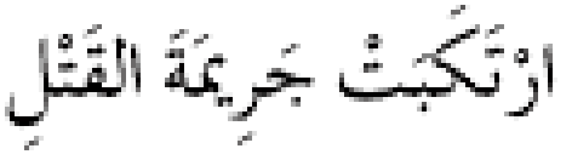

As you know, trying to UPSCALE things will result in some subpar images... but if you just needed something a little quick/dirty, I dabbled in this for a little and came up with this basic workflow.
Step 1
Original Image:
First you upscale the image:
Note: You can insert any % there. 1000% makes it 10x larger.
Step 2
Then you can adjust the contrast slightly:
convert test2[Scaled1000].png -contrast-stretch 3% test2[ContrastTweak3].png
Note: You can insert any % there. I found that anywhere from 1-5% seemed decent. Going beyond that distorted the text too much.
Step 3
Then you can scale the image down:
Note: You can use whatever % or size you want here. This results in a final image that is 4x larger.
Step 4
If you wanted to convert on an entire folder of PNGs, just go to the folder and run this:
convert *.png -scale 1000% -contrast-stretch 3% -scale 40% -set filename:fname %t_tn +adjoin %[filename:fname].png
Note: If you have a ton of images, probably better to run mogrify or come up with some sort of batch file. I read about the convert -set filename method here: https://www.imagemagick.org/Usage/ba...ogrify_convert
You could also probably introduce more steps in between (different resizing filters, etc. etc.), but I am not that familiar with that. Most of the time I am just using Imagemagick to clean up speckling in scans. :P
