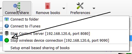

You can check the first one in calibre by pressing the Connect/Share button. If the WD driver is running then you will see something like the following image. The important bit is the green dot and the existence of IP addresses.

All of the times that I have tried to connect CC and calibre, that green light has been on, with the IP address and port listed, so I don't think that that is the issue.
Would that explain why the connection only succeeds rarely, or why it worked consistently (at least for the remainder of the evening) when I restarted my router?
