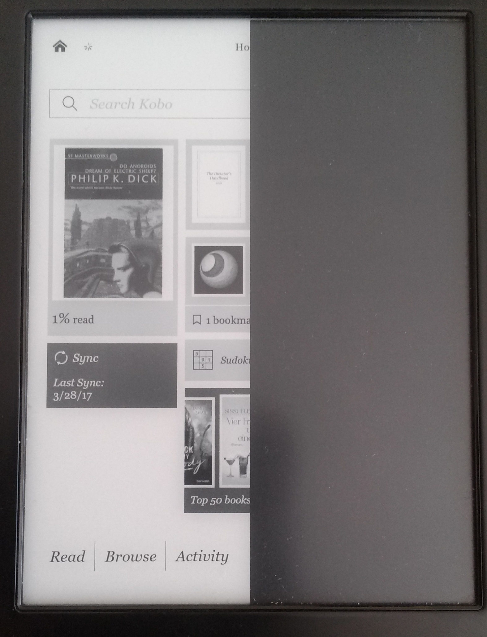

Could you post a photograph of the screen?
Old 03-29-2017, 07:12 AM   #13
eatthedishes
eatthedishes is as sexy as a twisted cruller doughtnut.eatthedishes is as sexy as a twisted cruller doughtnut.eatthedishes is as sexy as a twisted cruller doughtnut.eatthedishes is as sexy as a twisted cruller doughtnut.eatthedishes is as sexy as a twisted cruller doughtnut.eatthedishes is as sexy as a twisted cruller doughtnut.eatthedishes is as sexy as a twisted cruller doughtnut.eatthedishes is as sexy as a twisted cruller doughtnut.eatthedishes is as sexy as a twisted cruller doughtnut.eatthedishes is as sexy as a twisted cruller doughtnut.eatthedishes is as sexy as a twisted cruller doughtnut.
Posts: 14
Karma: 15318
Join Date: Apr 2015
Device: Kobo Aura H2O
It looks the same if I open a book and disappears when i leave nickel.

When you did the manual install, did you make sure you used the correct package for the Aura H2O? I would suggest downloading it again and installing it.
If the above doesn't fix it, you probably have to do a factory reset. But, you can take a copy of everything on the user partition and restore this after the factory reset. That way you won't lose the book status.
I used the Update for the Mark5 hardware.
